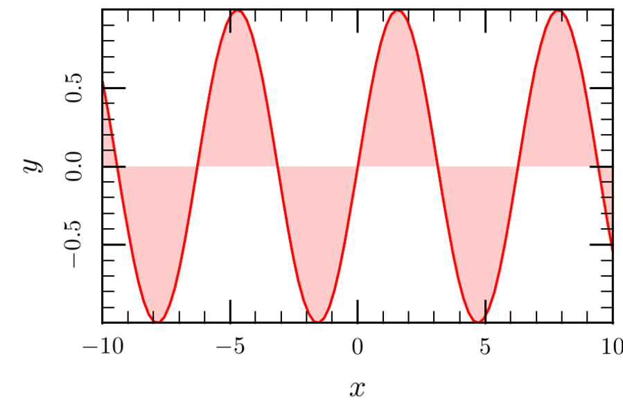

I attached a example, as image. In this image both the high and lows are filled with color. Assuming the line passing through the middle is avg. Can I just fill in the peaks (highs) ?
This is example from the web. Here both Peaks and troughs are filled. I Just want peaks filled.
I did a similar example here. This is a Delphi example. In .NET you can do something like the code below using CrossPoints function and HighLow series.
