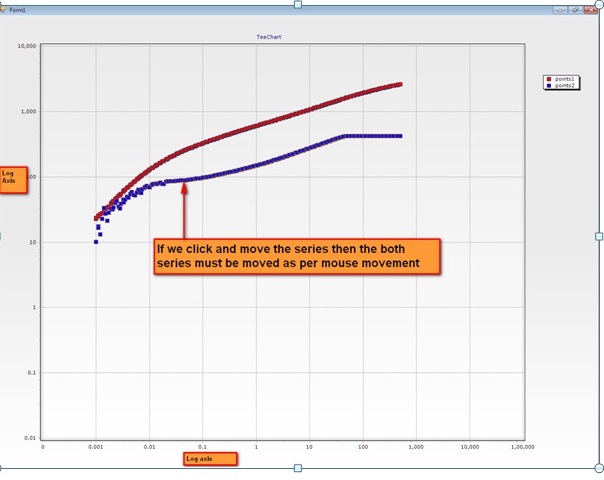

I am using tee chart Point series in Window form application, here I am facing one problem related to moving point series on my chart whose Left and Right Axis is Logarithmic.
please see the attachment below. It will so helpful for us if you please provide any alternative solution.

- Moving point series in logarithmic AXIS
- Untitled11.jpg (69.49 KiB) Viewed 26087 times

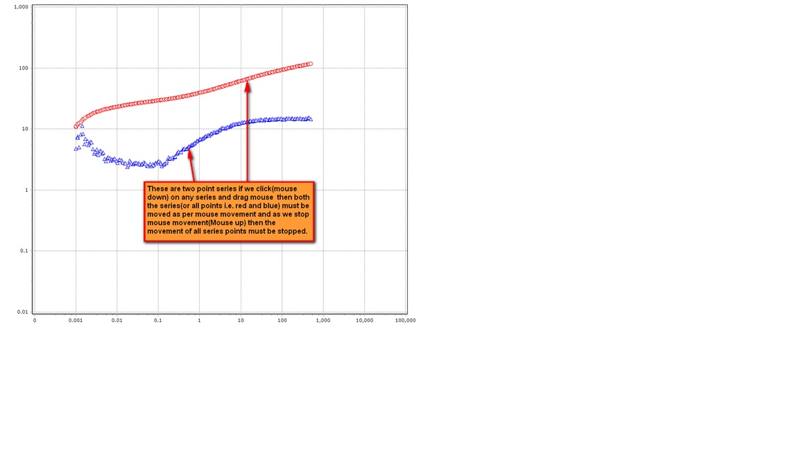

Your reply is helpful for us but not exactly resolving our issue. Now we are attaching a vedio showing the need.
In this when we click and move the whole curve is moved and when we mouse up then the curve or data plotted as per axis values.One important thing is that when we move curve then the shape of curve does not changed.

- PointSeriesMove1.rar
- (366.73 KiB) Downloaded 907 times
