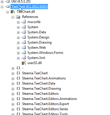

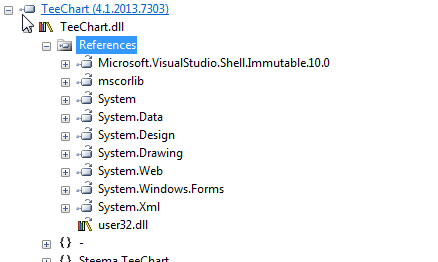

Re: Upgrade issues with recent versions
To clarify my point, I'm attaching to screenshots of different versions of TeeChart, 4.1.2012.9283 and 4.1.2013.7303, to highlight the different dependencies. The 2012 version does not have a dependency on Microsoft.VisualStudio.Shell.Immutable, which I am not shipping and thus causing the error on my client's machines. Can I compile the newer version myself without the dependency, and why is it needed?
- TeeChart 2013
- TeeChart-2013.png (10.69 KiB) Viewed 15131 times
- TeeChart 2012
- TeeChart-2012.png (14.12 KiB) Viewed 15122 times
