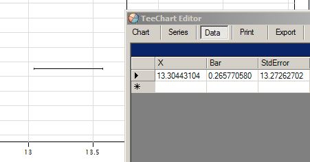

We want to plot error series with left and right error style in which std. error values would be greater than bar values for error series points.
To illustrate the problem, let’s consider following scenario:
Say we have error series with one point value as - X = 10 ,Bar = 0.3 and Std. Error = 0.7.
The problem we are facing while plotting above series is that Std. error value cannot be set beyond Bar value.
When the Std error value is set to greater than that of bar value; internally tee chart uses bar value as Std. error value and discards whatever we provided earlier. (Screen shot Version 2010).
In other words, tee chart is supposed to expect std. error value to be less or equal to that of bar value, as observed from the plotted series.
We tried the same scenario in ocx tee chart and it works fine (Screen shot Version 2008).
Please suggest a solution so that we can set our own standard error value and succeed in avoiding tee chart overwriting it with bar value( especially when std. err > bar value).

- Version 2010.PNG (9.55 KiB) Viewed 24009 times
- Version 2008.PNG (13.65 KiB) Viewed 23947 times

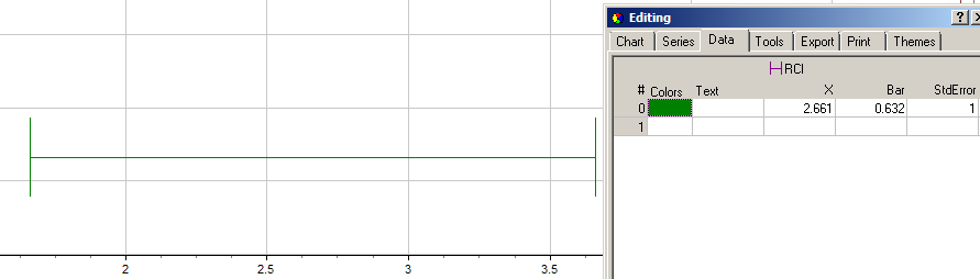

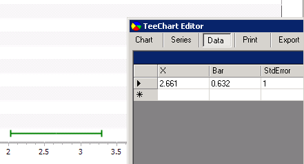

Here are the new set of images one using tee chart for .net and other using ocx.
Both has same data as:
x = 2.661
bar = 0.632
std err = 1
When we compare these images we find following set of differences:
for ocx control : minimum of bar is < 2, also max of bar > 3.5
for .net control : minimum of bar is > 2, also max of bar < 3.5
This says about the problem - with same data, ocx and .net control are drawing it differently.
We find the ocx way more correct and want to have the same for .net control.
Chandran

- Error series with left right style - minimum of bar is < 2, also max of bar > 3.5
- Version tee chart (ocx).PNG (13.65 KiB) Viewed 23988 times
- Error series with left right style - minimum of bar is > 2, also max of bar < 3.5
- Version tee chart (. Net).PNG (6.78 KiB) Viewed 23950 times
