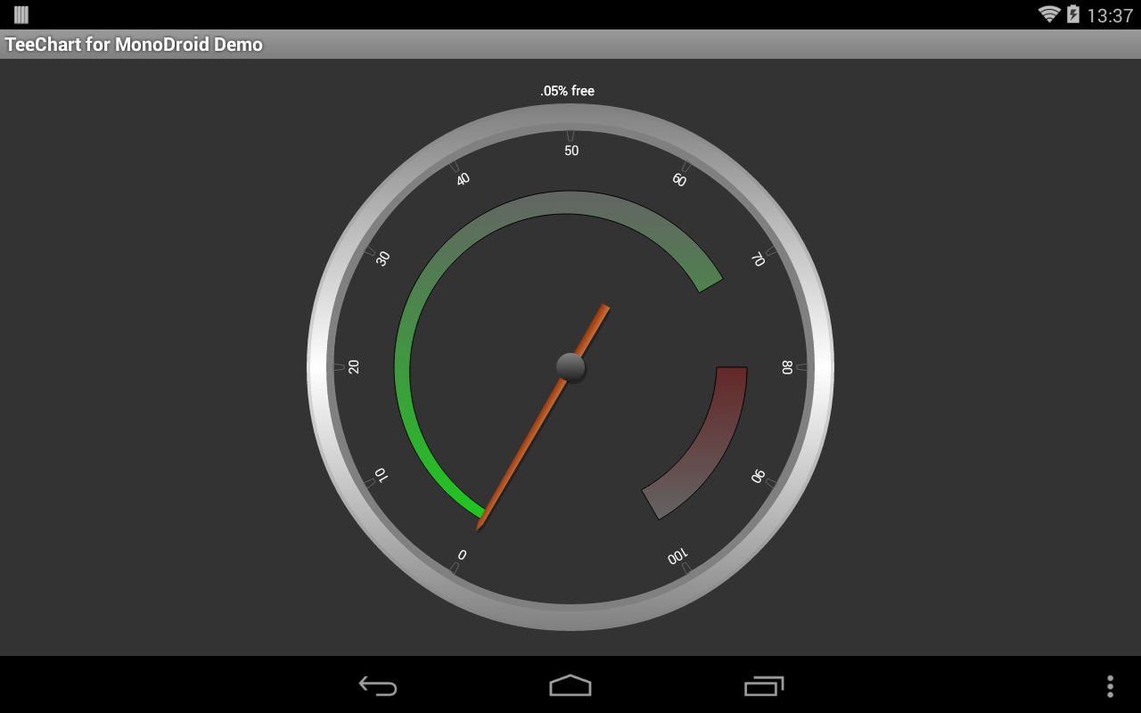

Thanks for your reply. Ok, the problem is not about pens but brushes. I created a chart using this code:
    private Steema.TeeChart.TChart tChart1;
      tChart1 = new Steema.TeeChart.TChart(this);
      Steema.TeeChart.Themes.BlackIsBackTheme myTheme = new Steema.TeeChart.Themes.BlackIsBackTheme(tChart1.Chart);
      myTheme.Apply();
      string hexColor = "#333333";
      ColorConverter converter = new ColorConverter();
      Color c = (Color)converter.ConvertFromString(hexColor);
      Steema.TeeChart.Styles.CircularGauge circularGauge1 = new Steema.TeeChart.Styles.CircularGauge(tChart1.Chart);
      circularGauge1.FaceBrush.Gradient.Visible = false;
      circularGauge1.FaceBrush.Color = c;
      tChart1.Panel.Color = c;
      SetContentView(tChart1);
Which produced this chart:

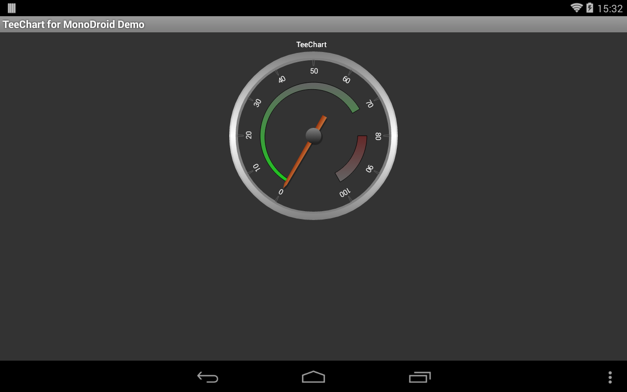

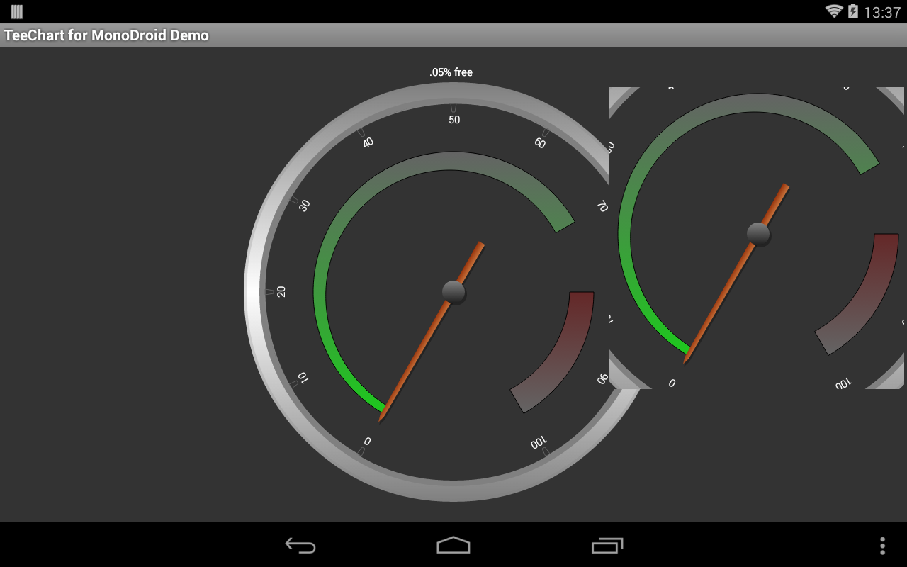

I copied a section of the CircularGauge over the panel to compare colors:

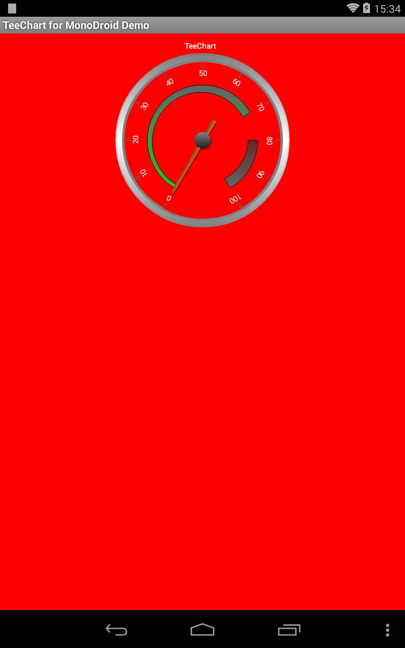

Honestly, using latest TeeChart for Xamarin.Android build (v4.13.12.13) from December 2013, I can not see any difference between circularGauge1.FaceBrush.Color and tChart1.Panel.Color. This can also be seen in red, for example:
Can you see any color differences? Can you reproduce the problem with the code I posted? If not, can you please modify my code snippet so that we can reproduce the problem here? Finally, which TeeChart for Xamarin.Android build are you using?

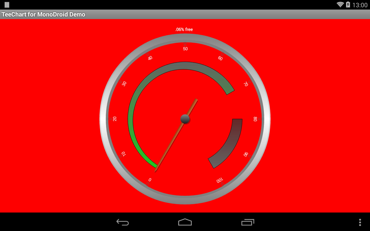

It produces those screenshots:
Does this code work fine at your end? Can you please modify it so that we can reproduce the problem here?
