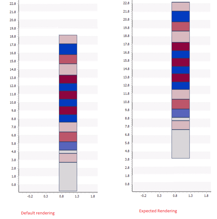

Is there any way to set start position for bar series with stack style set as self-stacked?
For instance, for the stacked bar series in attached snap, can we have starting position as 4.5 so that bar will start from this point?

I’ve tried the solution provided. But it is not as per our requirement.
I’ve attached an image which depicts what is expected to be rendered against the default rendering.
To elaborate more on this scenario, as shown in the “Default Rendering” image the Y-Axis starts from ‘0’.
But in our case, it should start at ‘3.8’ as shown in the “Expected Rendering” image.
Could you please suggest any solution?

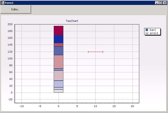

Here is sample forms application illustrating what we want.
It has one bar series with 10 points. Multibars property for bar series is set to self-stacked.
As can be seen after running it, bar series is drawn from (0,0) irrespective of specified x value in series data.
Here are the issues revisited:
Issue 1: Can we draw it from any given left axis value? For instance, if we want to draw it from y=5 onwards, is it possible?
Issue 2: Since all data points in this series are having x as 4, why this bar is drawn on x=0 and why not on x = 4?
To summarize, can we have customized starting position for bar drawing, say in this case, can we make the bar drawing start from (4,20) instead (0,0)?
Please let us know in case of any more inputs/clarification.
This is because of MultiBars.SelfStack, which stacks all bars to 0.
Yes, a solution that solves both issues would be applying some sort of offset to the axis labels using the GetAxisLabel event, for example:

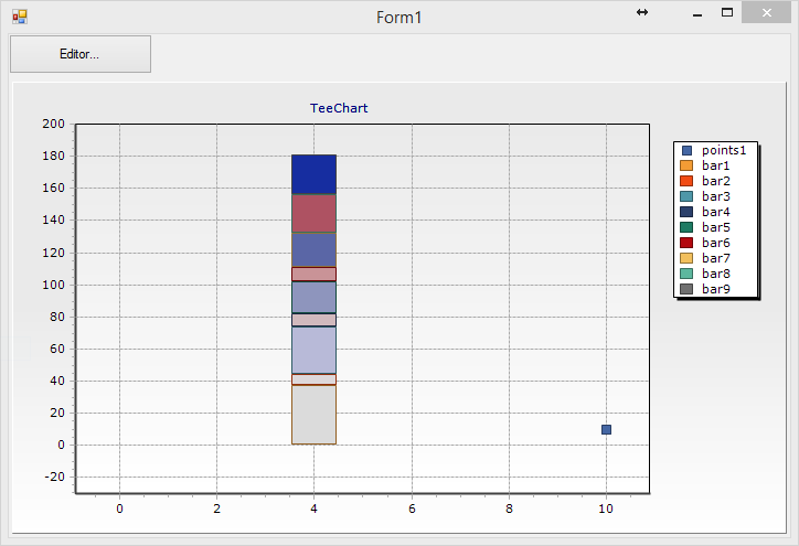

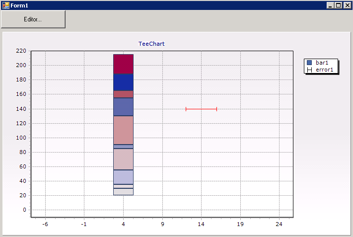

Thanks Narcis for the workaround. It works well provided that there is only one stacked bar series.
If chart has another series, it would also be affected with this change.
In our scenario, we do have another series and we want to apply this change to bar only.
To illustrate this, have a look at attached snaps: one is before changing axis labels, another snap shows chart after changing labels which is fine for bar but not intended for error series.
Can we just shift bar starting position to desired location and keep other series unaffected? We tried it using custom right axis for bar but haven’t succeeded in it?
Please suggest.

chandran wrote:Can we just shift bar starting position to desired location and keep other series unaffected? We tried it using custom right axis for bar but haven’t succeeded in it?
Please suggest.
I don't think the self-stacked bar style is going to do this for you, as the XValue is always set to the index of the series in the tChart1.Series collection, that is, zero in this case. An alternative would be to use several different bar series with a stacked style, e.g.

This gives me the attached image (the points series here just a placeholder for a second series):
