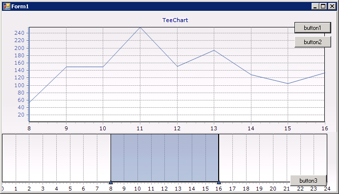

If I have a custom axis with a manually set margin and I add a page scroller it doesn respect the margin.
Please find the example, press button2, and the button1
http://193.145.251.126/pnp/files/rjiKjX ... croll2.zip

wakeup wrote:If I have a custom axis with a manually set margin and I add a page scroller it doesn respect the margin.
As we've discussed before, I believe, the ScrollPagerTool uses sets TChart.Chart.CustomChartRect to TRUE every time it is painted, so making these margins non-functional. One workaround would be:

acastro
Posts: 204
Re: ScrollPager doesn't respect the margin of customaxis
Post by acastro » Thu Mar 06, 2014 10:40 am
Ok thanks, but with that code the scrollpager axis doesn't have any values...

Please press first the button2 to add the custom axis, and then button1 to add the scrollpager
Post by Christopher » Thu Mar 06, 2014 11:11 am
wakeup wrote:Please press first the button2 to add the custom axis, and then button1 to add the scrollpager
Yes, that's because when the ScrollPagerTool clones the Series internally, it clones a series with a custom axes specified onto a chart that does not have one.
That is to say, if you wish to use a Custom Axis in a Chart with an associated ScrollPagerTool, please make sure you set the ScrollPagerTool.Series property before you do so, as one does by pressing button1 and then button2.
