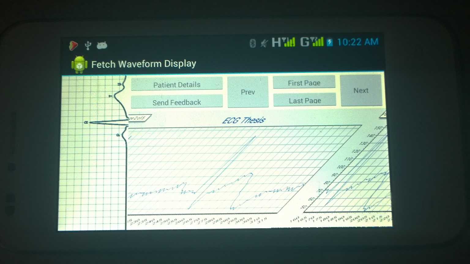

I used pages for my line graph but whenever I display an Alert Dialog or go to another activity (without finishing the activity containing the graph) and go back when go to other graph page it tilts. But before displaying and going to another activity, browsing graph pages is fine.
- WP_20140318_10_22_26_Pro.jpg (354.25 KiB) Viewed 19956 times

The steps you've mentioned SHOULD re-produce the problem. Here are the steps wherein at the end I encounter the problem:
METHOD #1:
1. Run the application.
2. Press the "FETCH" button.
3. Navigate through the chart pressing first, last, next and previous buttons. (This is to check whether the chart navigation is okay)
4. Press the "Patient Details" button.
5. Press the "Back" button of the dialog box.
5. Navigate through the chart as in step 3.
METHOD #2:
4. Press the "Send Feedback" button.
5. Choose the "Messaging" option
6. Press the "Just once" button
7. Press back button to go back to the chart screen of the application
8. Navigate through the chart as in step 3.
METHOD #3:
4. Press the "Home" button.
5. Hold the "Home" button and choose the running process of the application (or navigate through the application list and choose the application)
6. Navigate through the chart as in step 3.
I'm debugging using an Android-based smartphone by the way since the simulator is slow.
