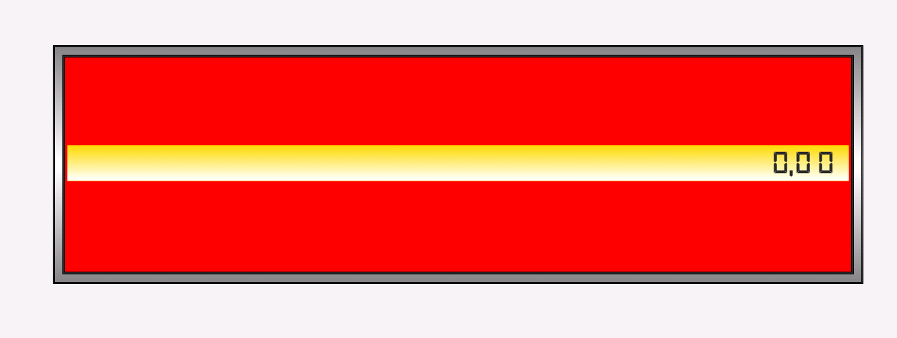

Post by acastro » Thu Mar 20, 2014 11:17 am
I have changed the facebrush color to red, but I didn't find how to change the background color of the number

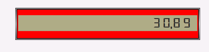

Post by Christopher » Fri Mar 21, 2014 1:17 pm
wakeup wrote:I have changed the facebrush color to red, but I didn't find how to change the background color of the number
Try:
      NumericGauge series = new Steema.TeeChart.Styles.NumericGauge(tChart1.Chart);
      series.FillSampleValues();
      series.FaceBrush.Gradient.Visible = false;
      series.FaceBrush.Color = Color.Red;
      foreach (Marker item in series.Markers)
        item.UsePalette = false;
        item.Shape.Gradient.Visible = false;
        item.Shape.Color = Color.Red;

Post by acastro » Fri Mar 21, 2014 4:31 pm
It doesn't run. I don't know why is it yellow...
Is it possible to chanche from charteditor?

Post by Christopher » Mon Mar 24, 2014 12:10 pm
wakeup wrote:It doesn't run. I don't know why is it yellow...
The code I posted works as expected using TeeChart v.4.1.2014.02240 - which version are you using?

Post by acastro » Mon Mar 24, 2014 12:33 pm
Sorry, you are right, it runs. Thanks
