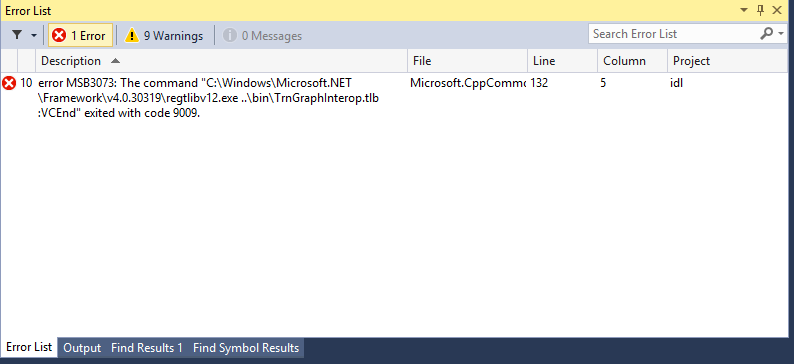

Petr wrote:here you can find my project with test application. Here's the build order:
I think I must be doing something wrong. I start with this:
but when I build I get this:

Hi Chrostopher! Probably you have a different path to regtlibv12.exe, in this case you can try to change the path in Command line in Post-Build events property page of idl project. On the othe hand i can say you that you don't need to complie idl and InteropApp, because they are already compiled to bin folder, so you can find them there. So, i hope, with managed projects you won't have any problems.
