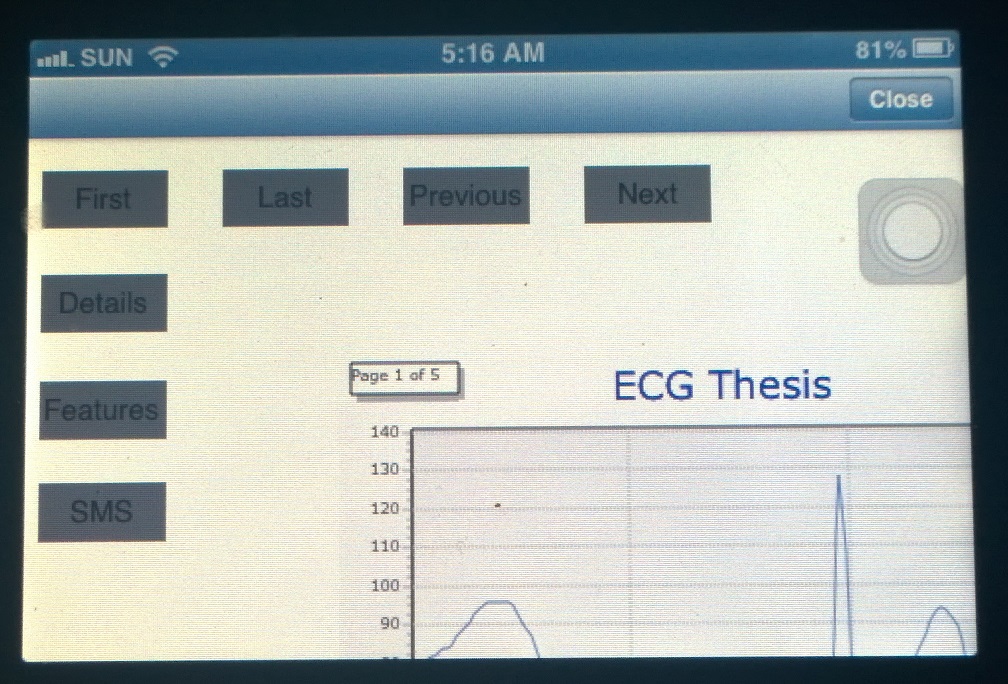

I'm having a problem with the generated chart because it is always misplaced (see attachement). My project is locked at landscape view and still it is not properly displayed. I use a "UIImageView" object to reference as a frame and also the chart is added as a subview (or View in some test).
In the attachement, the chart should be a little underneath and beside the buttons and throughout the remaining spaces. Also, I'm using an iPhone 3gs as a test device.

please take a look at the TeeChartBuilder example (which is included within the installer) code. There you can find a way to fix where the chart is placed, once the device is rotated, basically :
		public override void ViewDidAppear (bool animated)
			UIDevice.CurrentDevice.BeginGeneratingDeviceOrientationNotifications();
			CheckPositions ();
		public override UIInterfaceOrientationMask GetSupportedInterfaceOrientations ()
			return base.GetSupportedInterfaceOrientations ();
		private void DeviceRotated(NSNotification notification)
			CheckPositions();
		public override void DidRotate(UIInterfaceOrientation fromInterfaceOrientation)
			CheckPositions ();
		private void CheckPositions()
			// Refresh Chart rotating the device
			chart.RemoveFromSuperview ();
			RectangleF f = new RectangleF(View.Frame.X,50,View.Frame.Width,View.Frame.Height-BottomBar.Frame.Height-50);
			chart.Frame = f;
			View.AddSubview (chart);
			chart.DoInvalidate ();
			BottomBar.Frame  = new RectangleF (0,View.Frame.Height-50,
				this.chart.Frame.Width,50);

Actually the supported view of my app is just "Landscape" view as I'm having a hard time dealing with the orientation. Nevertheless even if the app only supports one orientation, the chart generated by TeeChart is still misplaced.

so, if I understand, you need to open a new View, in landscape mode and be able to show the Chart as a client or at specific position, isn't it ?
I'm asking to you in order to prepare a code that does that.

No Sir, I have no problem in the orientation since I set it to only support lanscape mode. The chart is misplaced :)

ok, would you be so kind to post here the lines of code that shows how you're adding the Chart to the View (or into the UIImageView) ? You should take the ImageView Frame as reference to set the TChart frame.
