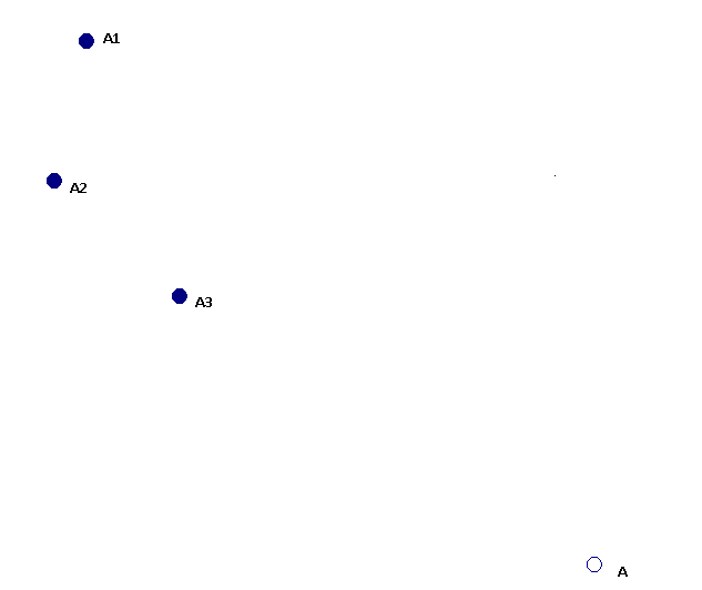

Hi ,
I need to show the title of the point and shape of the point same as attached image. How can i implement this.

Hi
Thanks for the quick response but I need point title same as Image. Means right of the point.

Post by amol » Wed Jun 04, 2014 10:39 am
and the point shape should be same as image
Re: Title of the Point
Post by Christopher » Thu Jun 05, 2014 10:52 am
amol wrote: Thanks for the quick response but I need point title same as Image. Means right of the point.
amol wrote:and the point shape should be same as image
You could try something like this:

i used
g.TextOut(lstCustomPointsSeries.CalcXPos(0), lstCustomPointsSeries.CalcYPos(0), lstCustomPointsSeries.Title); and problem is resolved.
