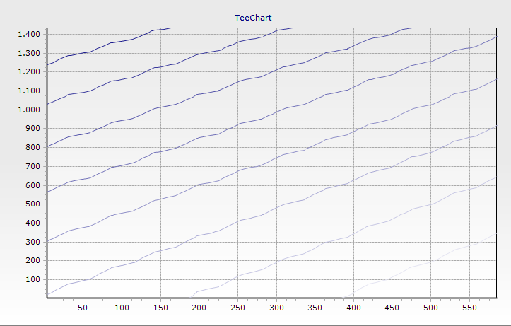

Re: How to draw contour from given data?
Post by Christopher » Fri Aug 08, 2014 11:31 am
Actually, this probably works as you would better expect:
      Contour contour = new Contour(tChart1.Chart);
      contour.IrregularGrid = true;
      Random rnd = new Random();
      int count = Assignment_teechart.ContourData.ZValues.Count;
      int y;
      for (int x = 0; x < count; x+=46)
        for (int z = 0; z < 47; z++)
          y = x > 0 ? z * (x / 46) : z;
          contour.Add(Assignment_teechart.ContourData.XValues[z], Assignment_teechart.ContourData.YValues[y], Assignment_teechart.ContourData.ZValues[x]);
Which gives me this:

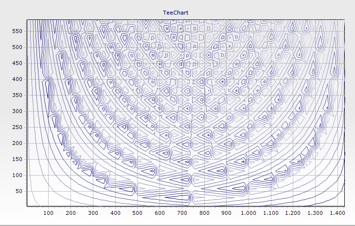

A third answer :)
Using
Contour2.zip
(11.36 KiB) Downloaded 797 times
and the following code:
      int length = Assignment_teechart.ContourData.ZValues.Count;
      int y = 0;
      for (int x = 0; x < length; x += 47)
          contour.Add(Assignment_teechart.ContourData.XValues[x], Assignment_teechart.ContourData.YValues[y], Assignment_teechart.ContourData.ZValues[z]);
          y++;
I get this:
not as pretty as the last answer, but probably more faithful to the original data.
