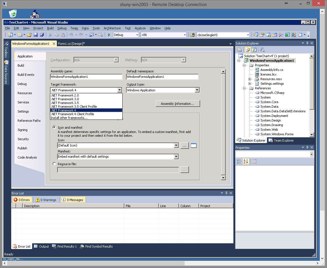

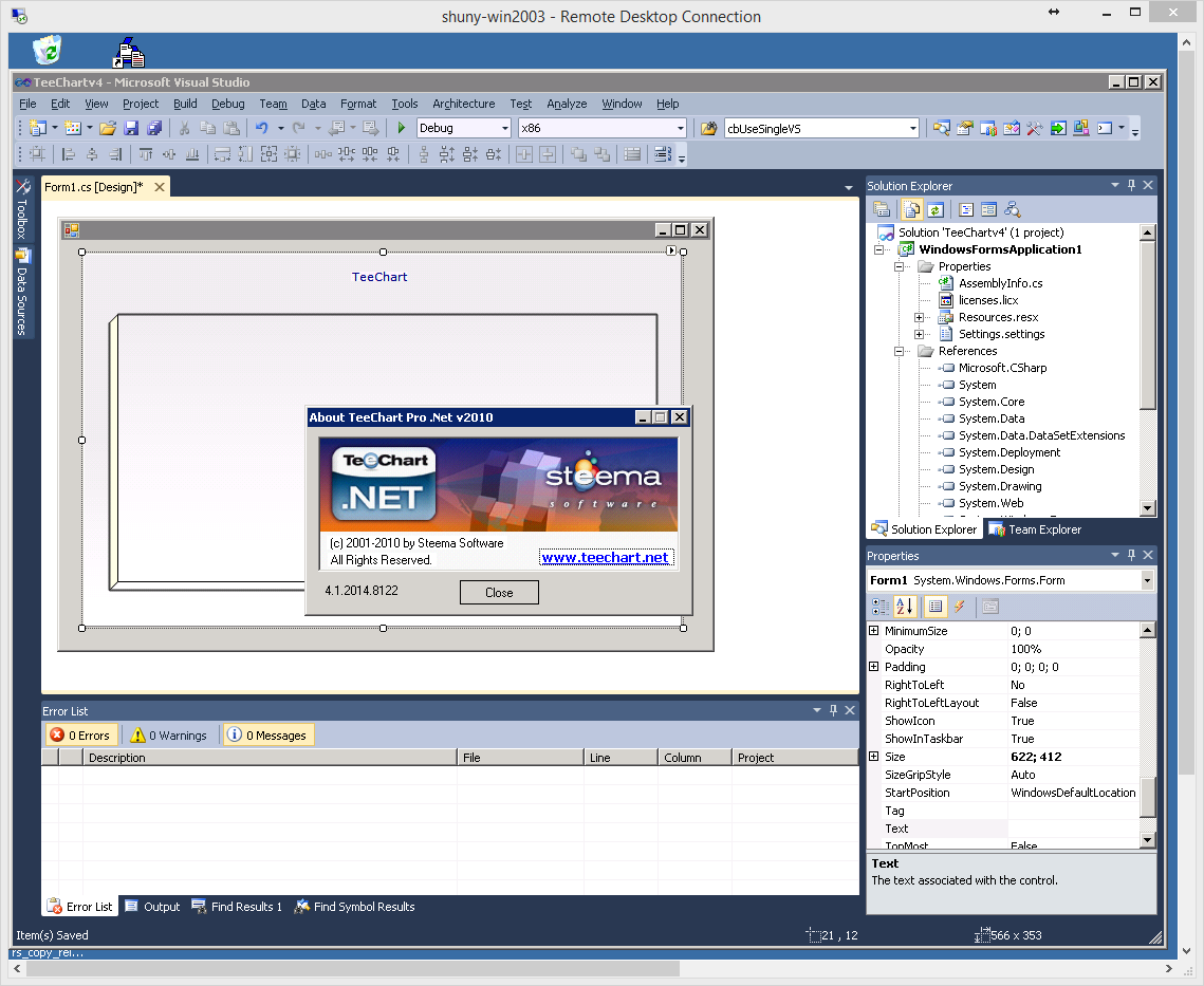

This seems to work fine here, as can be seen in the following image:
Are you sure you have the "Target Framework" of the project set to ".NET Framework 4" and not ".NET Framework 4 Client Profile"? e.g.

Re: Teechart lead to vs.net restart
Post by Christopher » Wed Sep 17, 2014 8:48 am
YingHui wrote: Yes, I am using the .Net Framework 4.
Not sure if it relates with the configuration with my project and vs.net.
I'm not sure either. As you can see, I'm using the same TeeChart.dll as you are in the same version of Visual Studio and with the same version of the .NET Framework.
