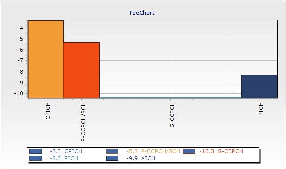

Hello:
I use the area to draw severl bar with different color each and I would like to make the color of symbol on the legend to be same with that related bar. However I only find the border of the symbol border is same with each bar, would you please let me know how I can fill the symbo with related bar area?
Attachment is the picture for your reference.
Ying-Hui

YingHui wrote: I use the area to draw severl bar with different color each and I would like to make the color of symbol on the legend to be same with that related bar. However I only find the border of the symbol border is same with each bar, would you please let me know how I can fill the symbo with related bar area?
Unfortunately this is a defect which I have added to our database with id=934. Fortunately there's an easy runtime workaround, which is to derive a new class from Area and override the method which is causing the problem, e.g.
  public class MyArea : Area
    public MyArea(Chart c) : base(c) { }
    protected override void PrepareLegendCanvas(Graphics3D g, int valueIndex, ref Color backColor, ref ChartBrush aBrush)
       //leave empty
      MyArea area = new MyArea(tChart1.Chart);
      area.Add(1, 5, Color.Red);
      area.Add(2, 1, Color.Blue);
      area.Add(3, 4, Color.Yellow);
      area.Add(4, 2, Color.Green);
      area.Stairs = true;
