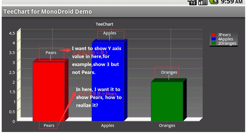

I have a problem when using TeeChart NET for Xamarin .Android product.Would you please have a look about my attachement? Thank you very much!

Candy wrote: I have a problem when using TeeChart NET for Xamarin .Android product.Would you please have a look about my attachement?
I think you should be able to use the Marks.Style property:
      tChart1.Series.Add(typeof(Bar));
      tChart1[0].Add(1, "Hello");
      tChart1[0].Marks.Style = MarksStyles.Value;
