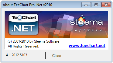

We are using following version of Teechart –
Teechart Version Detail
Teechart Version Detail.png (63.13 KiB) Viewed 23408 times

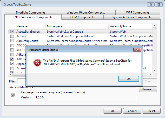

means Tee-chart is installed properly.but when I am adding 64 bit dll in toolbox then following message is coming .
Teechart error during adding.png (27.88 KiB) Viewed 23318 times
So it seems that 64 bit dll is not getting added. once it will be added then I think it will work properly.
So Why this error is coming?
So Should after 64 bit installation of Tee-chart any other thing need to be install ?

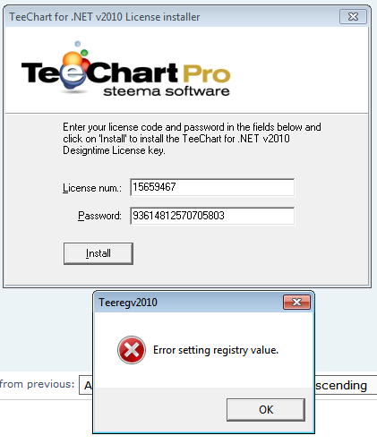

A part from this in Tee chart website following instruction was given --
"Please note: If installing TeeChart for development use in Windows 64Bit environment you should run the TeeRegV2009.exe/TeeRegV2010.exe utility after installation (see below)."
and when we are trying to install it then following message comes --
Error in registry Value..png (22.57 KiB) Viewed 23303 times
Kindly suggest ...
Re: Teechart problem with .net framework 4.5
Post by Narcís » Fri Dec 19, 2014 8:02 am
Amol wrote:"Please note: If installing TeeChart for development use in Windows 64Bit environment you should run the TeeRegV2009.exe/TeeRegV2010.exe utility after installation (see below)."
Are you running TeeRegv2010.exe as and Administrator? Right-click and choose "Run as Administrator"? Has the user you use administrator privileges?
