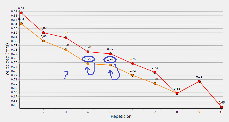

This may be an idiot question but I cannot find how to place marks/labels below (instead of above) the symbols in a Line graph. Where is the property to do this?

Hello Luis,
There are two options here:
1. Setting a negative value for Marks.ArrowLength, for example:
      line1.Marks.ArrowLength = -20;
2. Using custom marks position as shown here.

Thank you very much, Narcís!
First solution is simple and works fine for my purposes :)
