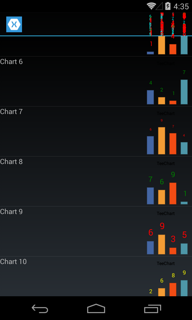

ISSUE 1:
On Android, if we put the charts in a ListView and scroll the ListView towards the end of the list, all the charts that scroll through the top navigation bar leave trails of their marks on the bar. We tried to figure out the cause but we couldn't and many tweaks we tried to put in didn't work for us. The behavior is identical on Emulator and Device both, and the issue remains the same across different versions of Xamarin.Forms too. We think this might be a bug in the Xamarin.Forms implementation of TeeCharts for Android. (Please see the attached screenshot)
ISSUE 2:
On Windows Phone, we are simply unable to use charts at all on most screens because if TeeCharts are placed inside a scrollable Xamarin.Forms container (like. scrollview or listview), the TeeChart.WP8.DLL crashes with a NullPointerException. We are think this might also be a bug in TeeChart for WinbPhone.
We've attached a sample project and screenshot to demonstrate the issues on both Windows Phone and Android.

ISSUE 1:
ISSUE 2:

Re: [Xamarin.Forms] Issues on WindowsPhone and Android
I can reproduce this in Android 4 and Android 5 emulators but can not reproduce it on several Android 5 devices and one Android 4 device. This somehow reminds me of this Xamarin.Forms bug I reported. In some occasions it produced a similar result. In which kind of device can you reproduce the problem on?ISSUE 1:
I could reproduce the problem here and added it (ID1102) to the defect list. My colleague Christopher Ireland will add a workaround and update on the issue status in a following post.ISSUE 2:

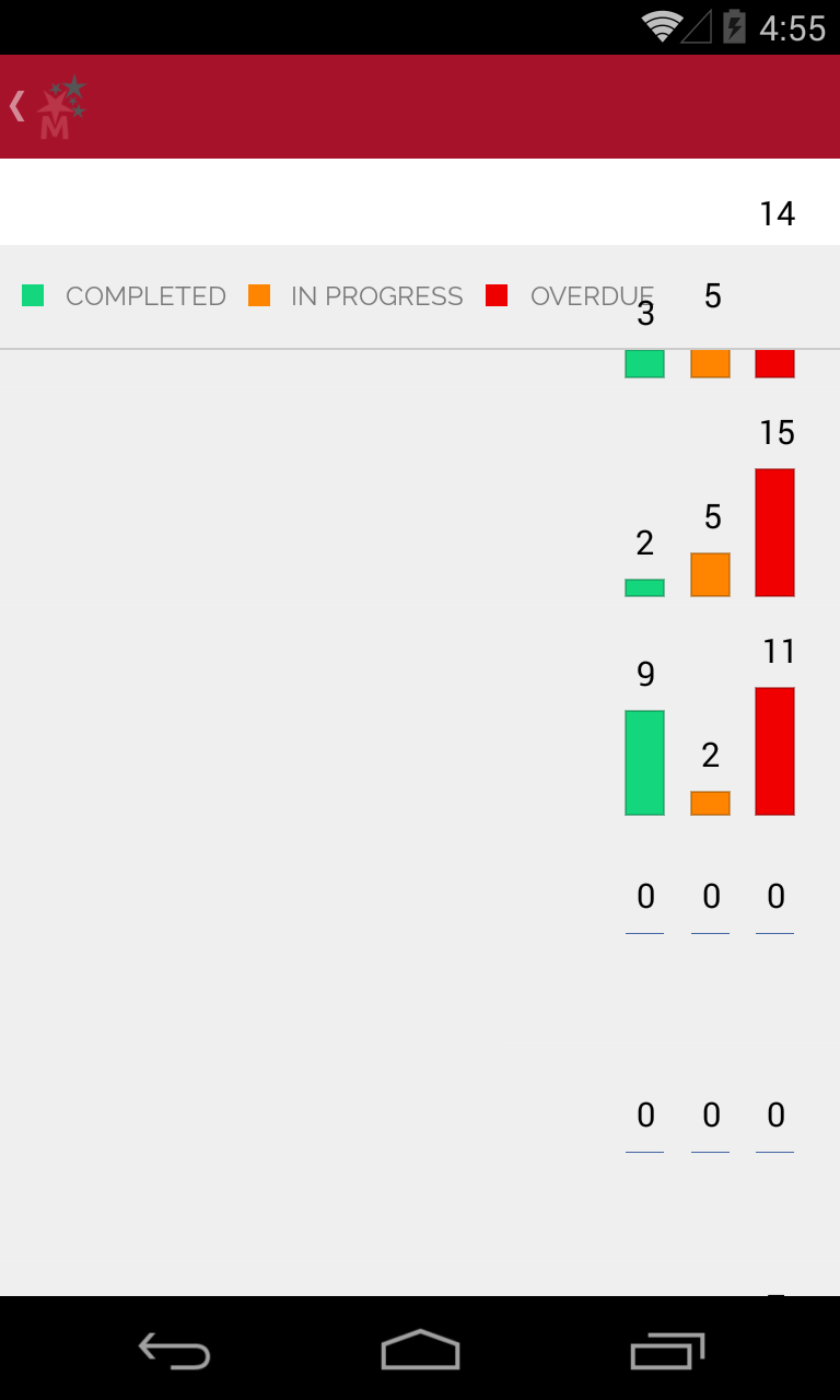

We can successfully reproduce the Android overlap issue on the following devices:
Also, as soon as the scroll clipping reaches middle of the charts the mark overlap disappears. Also, the overlap is only caused by the Chart Marks and nothing else (i.e. the panel, bars or anything else do not overlap).
I hope this information helps. I've attached a screenshot demonstrating the issue when some other components are placed before the ListView.
