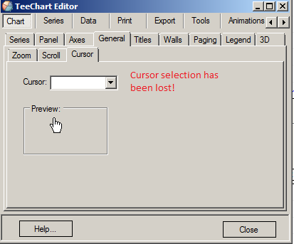

When opening up the designer for the teechart, I now discovered that for some reason the cursor selection has been lost on the whole teechart (see attached image).

I'm afraid that the fix to defect id=1020 has broken this functionality. Many apologies for any inconvenience this has caused. I have added this defect to our database with id=1115 and have already fixed it.
In the meantime, as a partial workaround (changes made in the Chart Editor will not be reflected), you can use this code:
    Bar series1 = new Bar();
      tChart1.Series.Add(series1);
      series1.Marks.Visible = true;
      series1.FillSampleValues();
      tChart1.MouseMove += tChart1_MouseMove;
    void tChart1_MouseMove(object sender, MouseEventArgs e)
      for (int i = 0; i < tChart1.Series.Count; i++)
        if(tChart1[i].Clicked(e.Location) > -1)
          tChart1.Cursor = Cursors.Hand;
          tChart1.Cursor = Cursors.Default;
