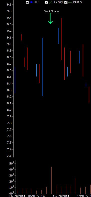

Post by Quant » Wed Feb 18, 2015 12:27 pm
while drawing Candle Stick Graph in Teechart.Net. When datavalue is not present for particular date it shows blank space (e.g.for Saturday, Sunday and Holiday.). previously when we were using Ocx version the candlestick graph was continuous without any blank space
Kindly see the attached file

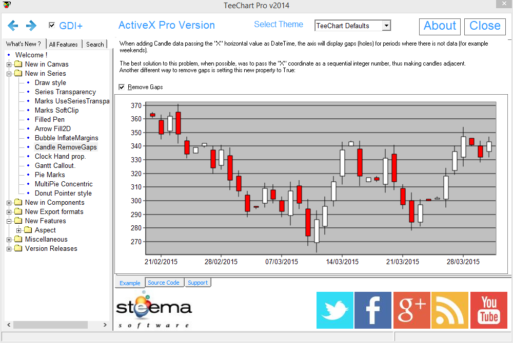

In the latest release notes we have:
This property can be used like this:
    Candle series1;
      series1 = new Candle(tChart1.Chart);
      Random r = new Random();
      double tmpOpen;
      double tmpClose;
      int count = 0;
      DateTime dt = DateTime.Today;
      TimeSpan ts = TimeSpan.FromDays(1);
      for (int t = 0; t < 13; t++)
        tmpOpen = r.Next(100);
        tmpClose = tmpOpen - r.Next(100);
        if (dt.DayOfWeek != DayOfWeek.Saturday & dt.DayOfWeek !=
          DayOfWeek.Sunday)
          ++count;
          series1.Add(dt, tmpOpen, tmpOpen + r.Next(50),
            tmpClose - r.Next(50), tmpClose);
        dt += ts;
    private void checkBox1_CheckedChanged(object sender, EventArgs e)
      series1.RemoveGaps = checkBox1.Checked;
