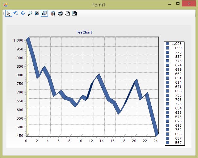

In the attached file you will see a part of a tchart with a distinct black border surrounding the image.
I have tried to remove this border using the code:
Chart.Panel.Bevel.Outer = Steema.TeeChart.Drawing.BevelStyles.None;
However, it does not help - the black border is still there. What else can I do to remove that border??

Post by Narcís » Fri Apr 17, 2015 8:14 am
Hi Friis,
Using this code snippet:
      tChart1.Series.Add(new Steema.TeeChart.Styles.Line()).FillSampleValues();
      tChart1.Panel.Pen.Visible = false;
      tChart1.Panel.Bevel.Inner = Steema.TeeChart.Drawing.BevelStyles.None;
      tChart1.Panel.Bevel.Outer = Steema.TeeChart.Drawing.BevelStyles.None;
in an empty chart I get this:
you can also try hiding the chart walls:
      tChart1.Walls.Visible = false;
If the problem persists at your end please attach a simple example project we can run "as-is" to reproduce the problem here.

I have attached an image generated in the following code.
I have taken the image generated below and then inserted the graph on a white blank page in windows Paint.
as you will see, a thin black line is still present??

Post by Narcís » Fri Apr 17, 2015 8:44 am
Hi Friis,
You're very welcome.
In that case this is the same problem discussed here.
Which in your case can be solved like this:
      tChart1.Clear();
      tChart1.BackColor = Color.White;
      tChart1.Panel.Bevel.Width = 0;
      tChart1.Header.Text = "";
      var bufferStyle = tChart1.Graphics3D.BufferStyle;
      tChart1.Graphics3D.BufferStyle = Steema.TeeChart.Drawing.BufferStyle.None;
      tChart1.Export.Image.Bitmap.Save(@"C:\Temp\jkhfw.bmp");
      tChart1.Graphics3D.BufferStyle = bufferStyle;

Post by Friis » Fri Apr 17, 2015 9:20 am
Super - this works fantastic ;-)
