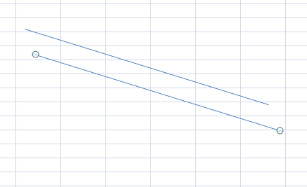

Currently we are having a requirement wherein we need to do following:
1] Select Already Drawn TrendLine (DrawLine Tool)
2] On right click that line, it should show a Context Menu having menu items like "Line Properties", "Create Parallel Line"
3] On click of "Create Parallel Line" it should create identical line which should be placed at some distance and parallel to original line.
For your reference check following screenshot:
Parallel Line.png (8.41 KiB) Viewed 11332 times
Any help on this would be greately appreciated.
Note: Prior to give help on above topic, please let us know a better approch to show context menu on right click of DrawLine tool ASAP.
