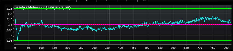

I'm having a problem to draw colorline behind series, anotations, etc. in my WPF .NET application.
I'm using these Colorlines as an tolerance limits for charts in steel mill visualization application.
Drawbehind = true property is used but Lines are always on top though.
Is there a way to fix it?
Thank you for your help.
Branislav Baran
this chart has series and annotation drawn behind the colorlines, but it is requred to have them drawn behind everything else.

Unfortunately the Drawbehind is non-functional in WPF as the tool uses an AdornerLayer to do its drawing, and this layer is always drawn before all others.
However, this behaviour can be overridden using a very simple derivative of the ColorLine class, e.g.
  public class MyColorLine : ColorLine
    public MyColorLine(Chart c)
      : base(c) { }
    public MyColorLine()
      : this(null) { }
    protected override void ChartEvent(EventArgs e)
      if ((iAxis != null) &&
       ((e is BeforeDrawSeriesEventArgs) || (e is AfterDrawEventArgs)))
        Chart.Graphics3D.Pen = Pen;
        DrawColorLine(Chart.Graphics3D, e is BeforeDrawSeriesEventArgs);
And then used like this:
      Steema.TeeChart.WPF.Styles.Line line = new Steema.TeeChart.WPF.Styles.Line(tChart1.Chart);
      line.LinePen.Width = 3;
      line.FillSampleValues();
      MyColorLine tool = new MyColorLine(tChart1.Chart);
      tool.Axis = tChart1.Axes.Bottom;
      tool.Value = 5;
      tool.Pen.Color = Colors.LimeGreen;
      tool.Pen.Width = 2;
      tool.DrawBehind = true;

Thank you Christopher,
it works fine!
