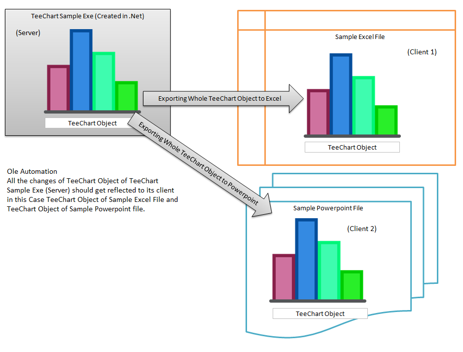

The above code tutorial shows connecting a TeeChart control to ADO.NET databases at design-time and at run-time. But our requirement is different. We need OLE Automation with TeeChart Control which is explained diagrammatically in following image.
TeeChart OLE Automation Concept
TeeChart OLE.png (54.83 KiB) Viewed 12741 times
Do revert for any clarification.
Re: TeeChart OLE Automation
Post by Narcís » Tue Aug 04, 2015 9:32 am
Hi Quant,
I'm afraid this is not possible. We discussed that here and hasn't been any change since.
