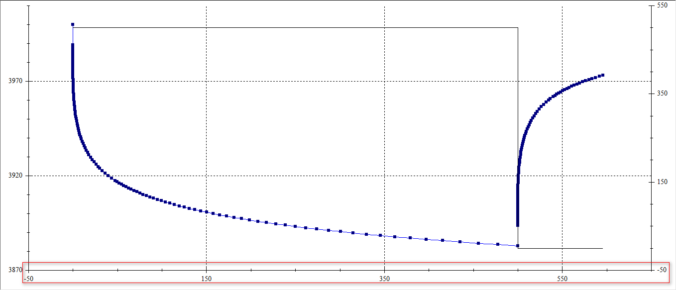

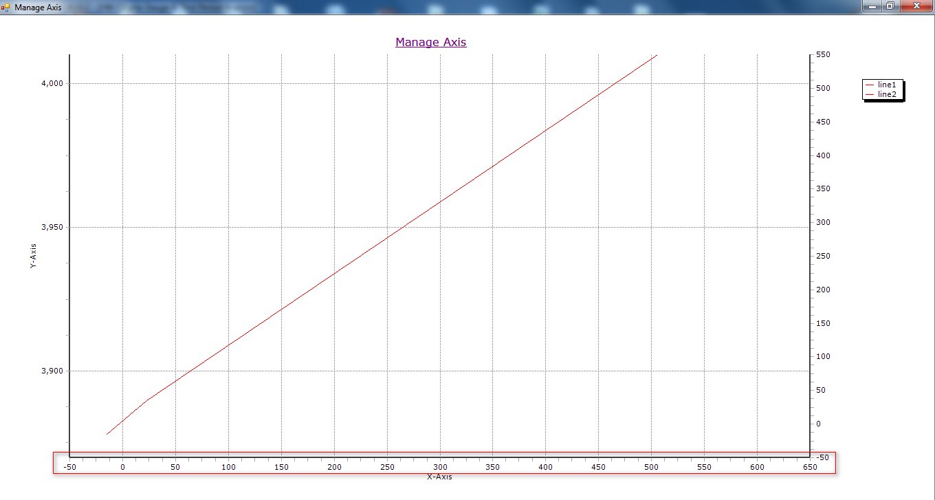

The below figure(1) shows according to all above input but not same as below figure (2).
Our max, min, tick increment and total no of tick are same but minor per major tick are not. So kindly let us know how to implement minor per major ticks in TChart 2012.
Figure-1
Figure-2
In figure-2, each minor tick has increment of 50, so is there any way in Steema Tchart to set increment of axis with respect to minor tick.
So, kindly suggest how to manage bottom axis of (Fig-1) according to (Fig-2) in TChart 2012 version, with respect to labels, ticks, minimum value, maximum value and grid lines of the axis.

I'm not sure about which is your exact question. However, you can have bottom axis in the example you sent (figure1) as in figure2 example using this code:
          tChart1.Axes.Bottom.SetMinMax(-50.0, 650);
          tChart1.Axes.Bottom.Increment = 200;
          tChart1.Axes.Bottom.IncrementOffset = 50;
          tChart1.Axes.Bottom.Labels.OnAxis = true;
          tChart1.Axes.Bottom.MinorTicks.Length = 4;
You can set Increment relative to the number of minor ticks using something like this:
          tChart1.Axes.Bottom.Increment = (tChart1.Axes.Bottom.MinorTickCount + 1) * 50;
Is this what you were looking for? Otherwise please provide more detailed information about your exact requirements.

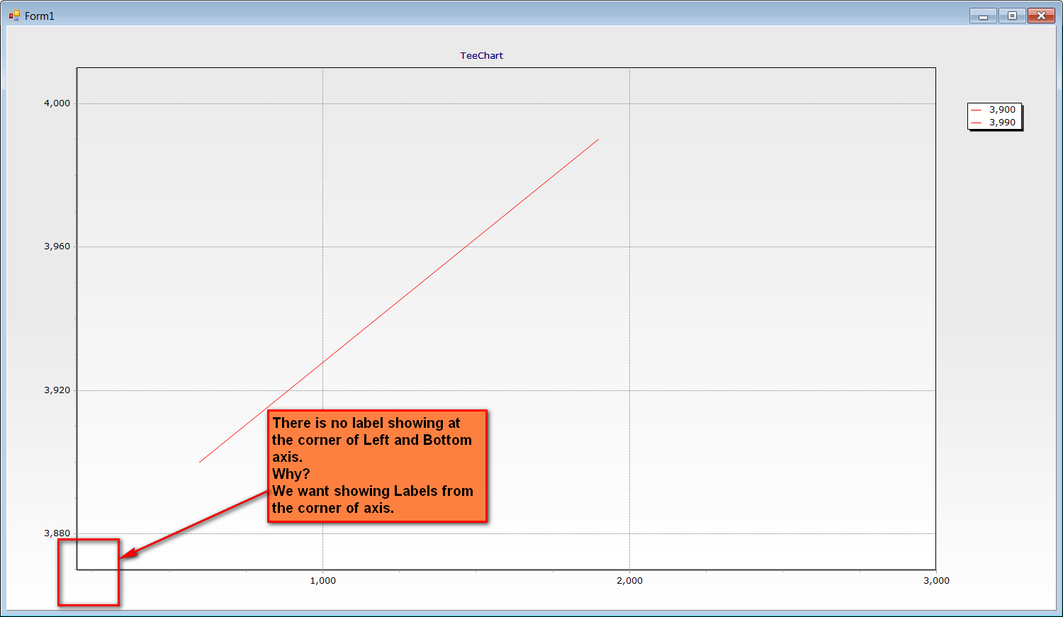

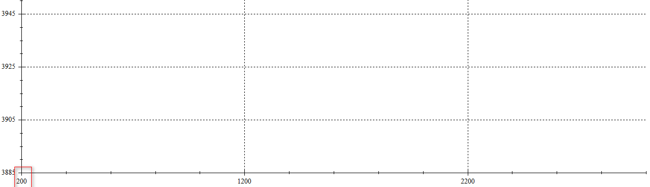

As shown in below figure-1, the left Axis label start showing from initial position which looks correct but on the other hand labels of bottom axis not start showing from initial position of axis.
We want to show axis labels of all axis from initial position as shown in Fig.2
Figure 1
Figure 2

Post by Narcís » Fri Aug 14, 2015 9:58 am
What about setting this?
I can not reproduce the problem with the project you sent and modifying axes settings according to your last post, complete code available below.

We are using the "OnAxis" property as shown below but it does not do anything.
Labels at the corner.png (41.11 KiB) Viewed 27911 times
We are attaching a new demo for better understanding.Please provide any solution asap.

Post by Marc » Mon Aug 17, 2015 10:50 am
OnAxis won't work in this case as it is looking to plot a regularly incremented label. I've added a feature request, http://bugs.teechart.net/show_bug.cgi?id=1272.
In the meantime there are other options to better control the Label output for non-standard requirements. Here are a couple:
This will add the label you require. It uses the TChart AfterDraw event:
using Steema.TeeChart;
using System.Reflection;
private void tChart1_AfterDraw(object sender, Steema.TeeChart.Drawing.Graphics3D g)
    //set x position for new label
    int x = tChart1.Axes.Bottom.CalcPosValue(tChart1.Axes.Bottom.Minimum);
    //tChart1.Axes.Bottom.Labels.position (here the Label y coordinate) is protected so need alternative technique for y...
    //(We'll add publicly scoped access for this variable for future releases)
    AxisLabels tmpLabels = new AxisLabels(tChart1.Axes.Bottom);
    FieldInfo privateField = tmpLabels.GetType().GetField("position", BindingFlags.NonPublic | BindingFlags.Instance);
    int y = (int)privateField.GetValue(tChart1.Axes.Bottom.Labels);
    string label = tChart1.Axes.Bottom.Minimum.ToString("#");
    //output text
    g.TextOut(x - ((int)Math.Round(g.TextWidth(label) / 2)), y, label);
This option allows you to set the exact labels you require from scratch, overriding TeeChart's own choice for labels:
tChart1.Axes.Bottom.Labels.Items.Add(tChart1.Axes.Bottom.Minimum, tChart1.Axes.Bottom.Minimum.ToString());
double incr = 500;
double labelvalue = tChart1.Axes.Bottom.Minimum + incr; //increment in steps of 500
while ((tChart1.Axes.Bottom.Minimum + labelvalue + incr) < tChart1.Axes.Bottom.Maximum)
    tChart1.Axes.Bottom.Labels.Items.Add(labelvalue, labelvalue.ToString());
    labelvalue += incr;
I hope that may be of help.
amol
Posts: 231
Re: Managing Axis Increment
Post by amol » Sat Aug 22, 2015 4:48 am
Hi Steema Support,
Thanks for your reply. its works fine for the labels.

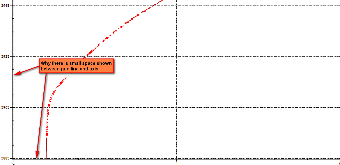

But we are facing one more problem i.e. shown in Figure 1. It shows small space between axis line and Grid line(Starting grid line) why? we are using MinimumOffset, MaximumOffset and IncrementOffset value 0(zero).
Figure 1

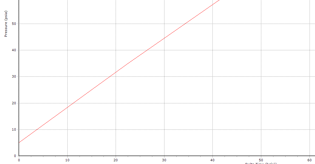

We want no space there as shown in figure 2 below.there is no space shown and grid line created with uniform interval.
please provide any solution. Thanks in advance.

We are attaching a Demo project for the same and will reproduce the problem(It shows small space between axis line and Grid line).
According to my understanding When we set line.Pointer.visible=True; then it shows the problem as given in demo.
Kindly provide any solution asap.

amol wrote:According to my understanding When we set line.Pointer.visible=True; then it shows the problem as given in demo.
I think you can resolve this with:
line.Pointer.InflateMargins = false;

Post by amol » Mon Aug 31, 2015 2:04 pm
Thanks!!! Christopher it works.
