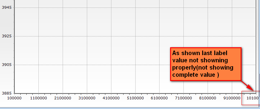

Hi Steema Support,
We are creating chart labels with large data values so in last label(that show Bottom maximum value) its does not show complete value properly as shown in fig. below:
Label
Is there is any way to manage labels size automatically according to labels data.

Hi PlanoResearch,
amol wrote: Is there is any way to manage labels size automatically according to labels data.
That's what automatic labels do. With custom labels you can add the code below after adding custom labels.
      tChart1.Panel.MarginUnits = PanelMarginUnits.Pixels;
      tChart1.Panel.MarginRight = tChart1.Axes.Bottom.MaxLabelsWidth();

Thanks! Steema Support it works successfully!!!
