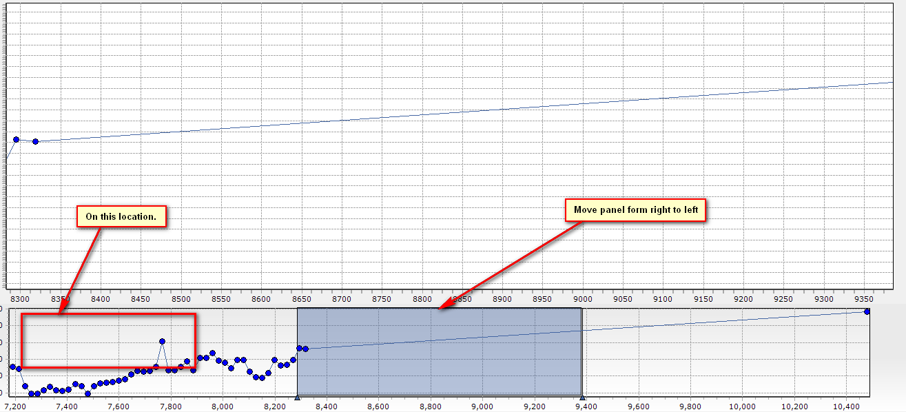

1. Change the panel positon from right to left.
Fig 1

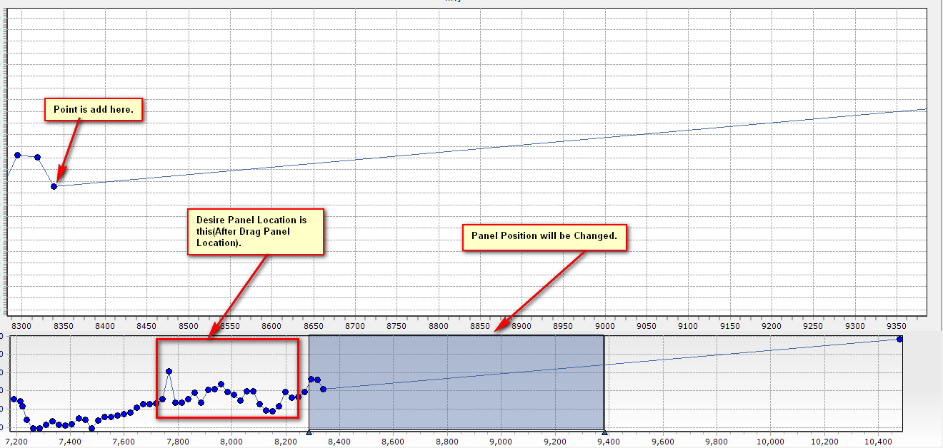

2. Add a point in Tchart and Upadate Subchart series. But zoom Panel location is Change.When we add a point on Tchart series , we want to not change Panel Location.
Fig 2

amol wrote:1. Change the panel positon from right to left.
I'm not sure of the requirement here - clicking and dragging on the panel easily changes its position, right?
amol wrote:2. Add a point in Tchart and Upadate Subchart series. But zoom Panel location is Change.When we add a point on Tchart series , we want to not change Panel Location.
Which code are you using to update the series?
amol
Posts: 231
Re: ScrollPager Zoom Panel Location.
Post by amol » Tue Sep 01, 2015 4:30 am
Update Subchart Series from below Code,
ScrollPagertool.SubChartTChart.Series.Clear();
ScrollPagertool.Series = line;
Post by Christopher » Tue Sep 01, 2015 9:28 am
amol wrote: ScrollPagertool.SubChartTChart.Series.Clear();
Okay, in which case you can try:
    private void button4_Click(object sender, EventArgs e)
      double min = tChart1.Axes.Bottom.Minimum;
      double max = tChart1.Axes.Bottom.Maximum;
      double start = tool.ColorBandTool.Start;
      double end = tool.ColorBandTool.End;
      series.Add(150, 10);
      tool.Series = series;
      tChart1.Axes.Bottom.Minimum = min;
      tChart1.Axes.Bottom.Maximum = max;
      tool.ColorBandTool.Start = start;
      tool.ColorBandTool.End = end;

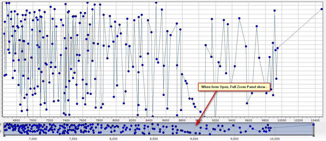

1. We want open full ScrollPager Zoom Panel in chart when first time chart open.
Zoom Panel.png (49.51 KiB) Viewed 15135 times
Post by Christopher » Thu Sep 03, 2015 12:56 pm
amol wrote:1. We want open full ScrollPager Zoom Panel in chart when first time chart open.
You can try:
    Line series1;
    ScrollPager tool;
      series1 = new Line(tChart1.Chart);
      series1.FillSampleValues(200);
      tool = new ScrollPager(tChart1.Chart);
      tool.Series = series1;
      tChart1.Draw();
      tChart1.Axes.Bottom.Minimum = series1.XValues.Minimum + 1;
      tChart1.Axes.Bottom.Maximum = series1.XValues.Maximum - 1;
