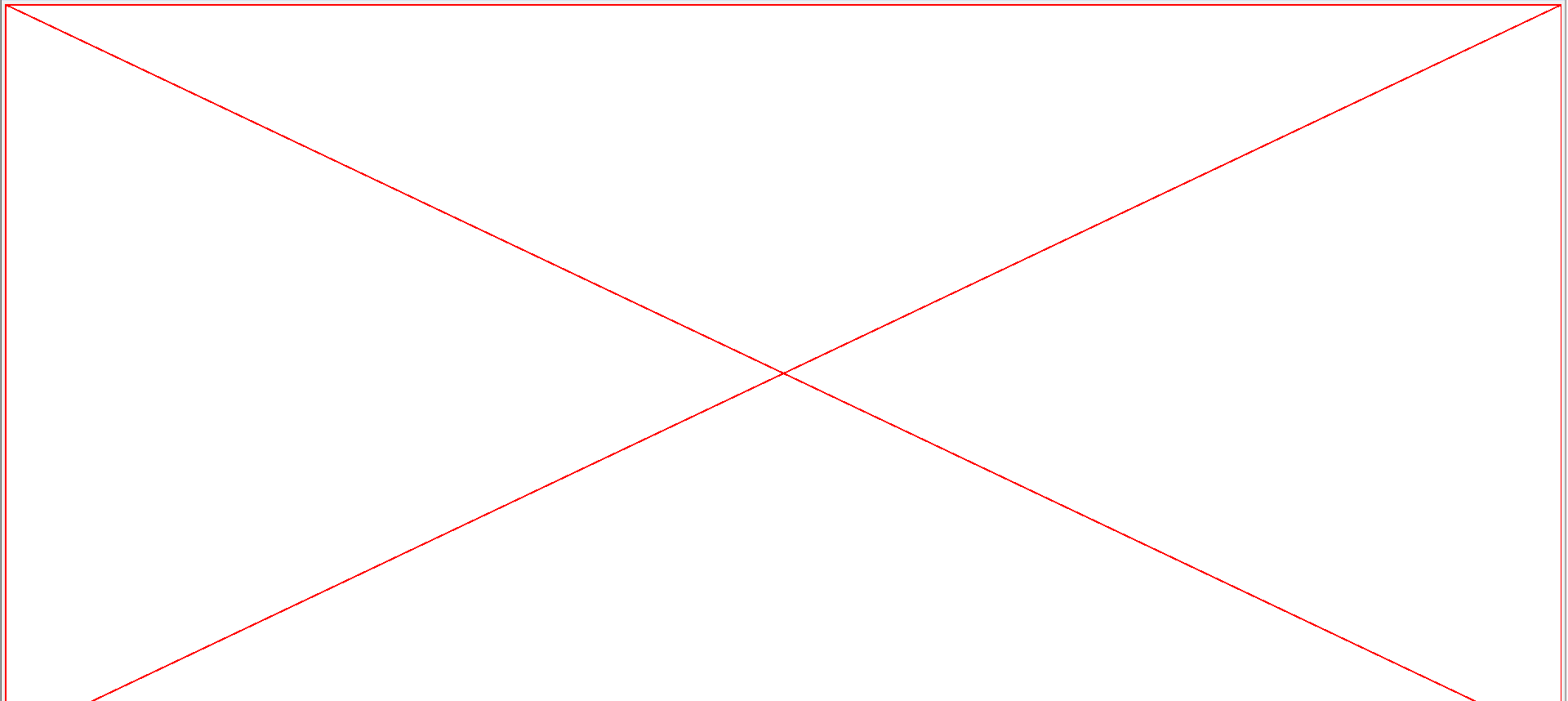

Post by amol » Thu Sep 17, 2015 12:49 pm
Thanks for reply,
As per your suggestion we are using Second technique i.e. sampling of data.
we are using the code below but shows crash on execution.
linePressure.Add( lstDataX.ToArray(), lstDataY.ToArray());
Steema.TeeChart.Functions.DownSampling downSampling = new Steema.TeeChart.Functions.DownSampling(tChart1.Chart);
downSampling.DisplayedPointCount = 2500;
downSampling.Method = Steema.TeeChart.Functions.DownSamplingMethod.MinMaxFirstLastNull;
linePressure.TreatNulls = Steema.TeeChart.Styles.TreatNullsStyle.DoNotPaint;
linePressure.Function = downSampling;
Please find the attachment .

Post by Christopher » Thu Sep 17, 2015 12:56 pm
amol wrote: As per your suggestion we are using Second technique i.e. sampling of data.
Can you please post to this thread a Short, Self Contained, Correct (Compilable), Example with which we can reproduce your problem here?
