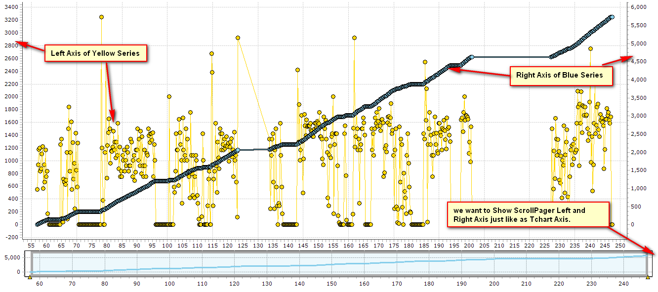

Hi steema,
we have some issues related to Scrollpager tool of Tchart given as below,
We want to show Left and Right axis on Scrollpager as shown in Tchart.
Series1 Y axis is Left.
Series2 Y axis is Right.
We want to show both axis of Series1 and Series2 in ScrollPager also.
image 1

amol wrote: We want to show both axis of Series1 and Series2 in ScrollPager also.
You could try:
      Line series1 = new Line(tChart1.Chart);
      Line series2 = new Line(tChart1.Chart);
      series1.FillSampleValues(400);
      series2.FillSampleValues(400);
      series2.VertAxis = VerticalAxis.Right;
      ScrollPager tool = new ScrollPager(tChart1.Chart);
      tool.Series = series1;
      tool.SubChartTChart[0].VertAxis = VerticalAxis.Both;
Please note that the ScrollPager tool only works with one series.

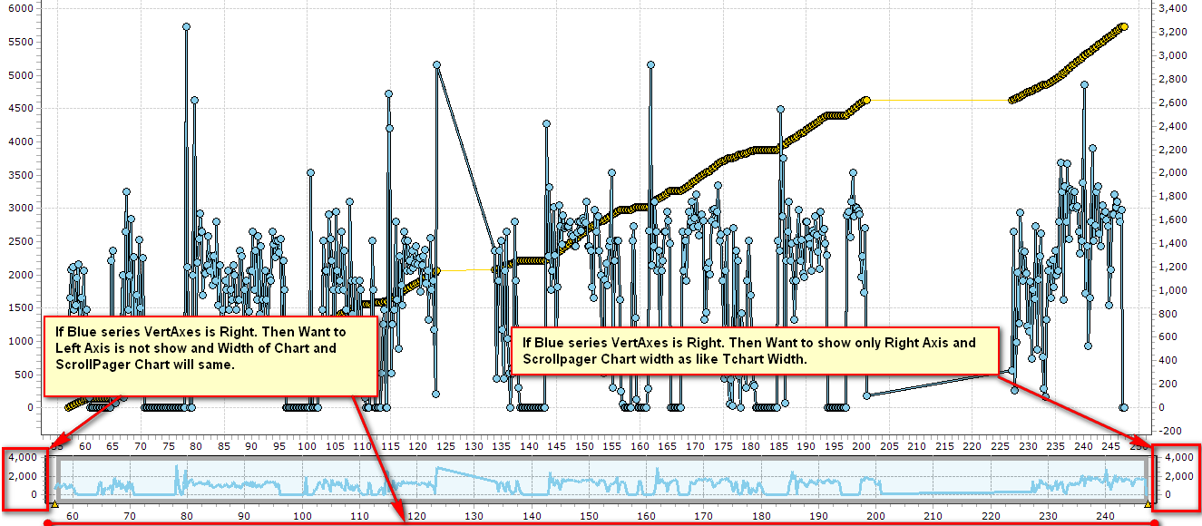

But we have one more query given as below,
if Series 2 Vertaxis property is Right then the Left Axis will be not show and Width of ScrollPager will also not change.
Image 1

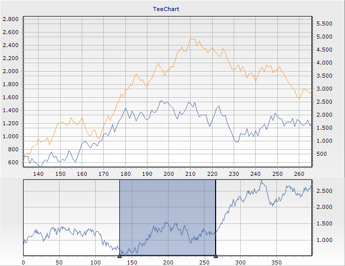

In the latest version of TeeChart.dll, the following code:
      tool.SubChartTChart[0].VertAxis = VerticalAxis.Right;
gives the following chart:
