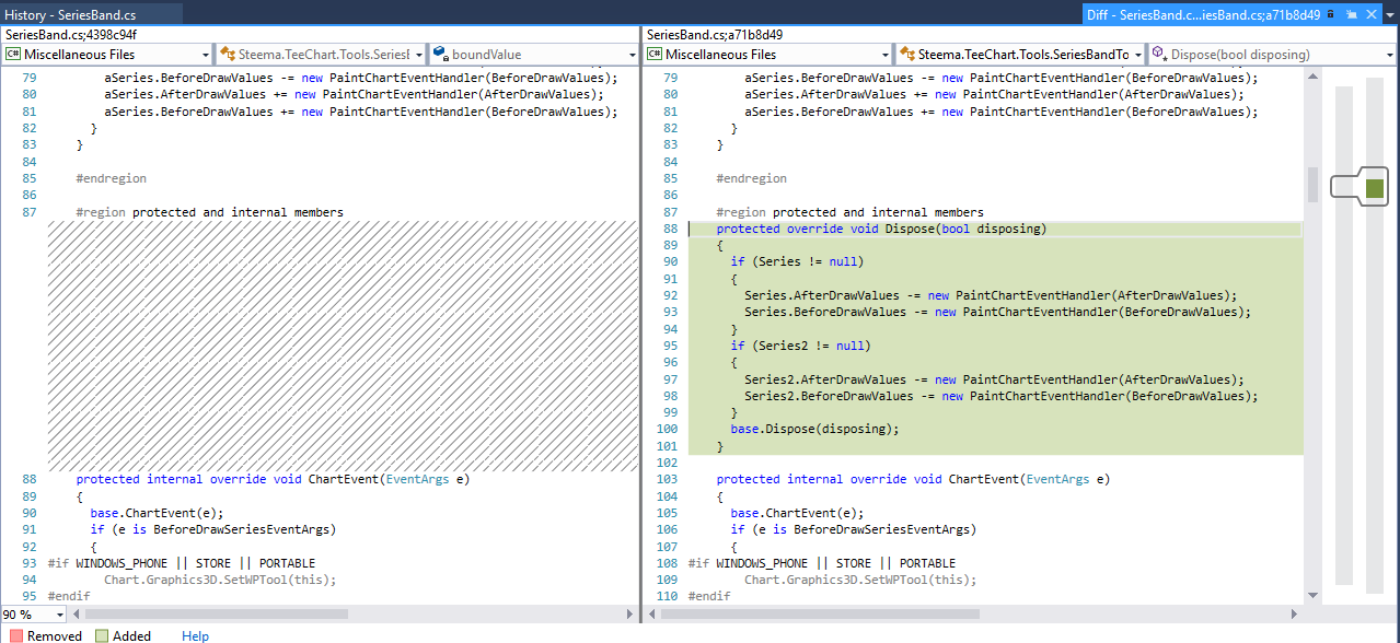

I have been able to reproduce this problem here and have added it to our issue tracking software with id=1367. This issue has now been fixed, and the fix required the following source code change:
This change will be made public with the next TeeChart maintenance release.
