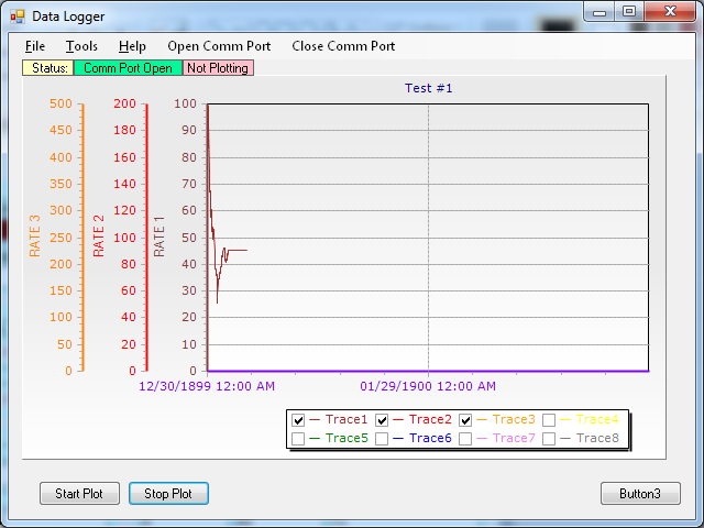

This first Image is the "Numeric" Mode screen shot.
Note the number of vertical lines as well as the starting value of 0.
This is what I expected.
On this Image, in "Time" mode, the starting value is "12/30/1899 12:00 AM".
I want it to be display whatever "Now" is ("11/13/2015 3:40 PM"). The ending value should display Now + 60 Minutes.
Also, it should have the same number of Vertical lines as in the 1st screen shot.
The only thing that should change is the text for the Bottom Axis.
In the code, the last 2 items are commented out.
If they are allowed to execute, only 1 vertical line appears, and the Bottom Axis text is "12/15/1963 12:00 AM"
So, What am I doing wrong?

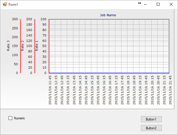

You could try something like this:
    TChart1.Header.Text = "Job Name"
    TChart1.Axes.Bottom.Minimum = 0
    TChart1.Axes.Bottom.Maximum = 24
    AddHandler TChart1.GetAxisLabel, AddressOf GetAxisLabel
    TChart1.Draw()
  End Sub
  Private Sub GetAxisLabel(sender As Object, e As GetAxisLabelEventArgs)
    Dim val As Double
    Dim now, label As DateTime
    If (DirectCast(sender, Axis).Equals(TChart1.Axes.Bottom)) And (Not CheckBox1.Checked) Then
      val = Convert.ToDouble(e.LabelText)
      now = DateTime.Now
      label = now.AddHours(val)
      e.LabelText = label.ToString(TChart1.Axes.Bottom.Labels.DateTimeFormat)
    End If
  End Sub
  Private Sub CheckBox1_CheckedChanged(sender As Object, e As EventArgs) Handles CheckBox1.CheckedChanged
    TChart1.Panel.MarginBottom = 30
    TChart1.Axes.Bottom.Labels.DateTimeFormat = "yyyy/MM/dd HH:mm"
    TChart1.Invalidate()
  End Sub
Which here gives me this:

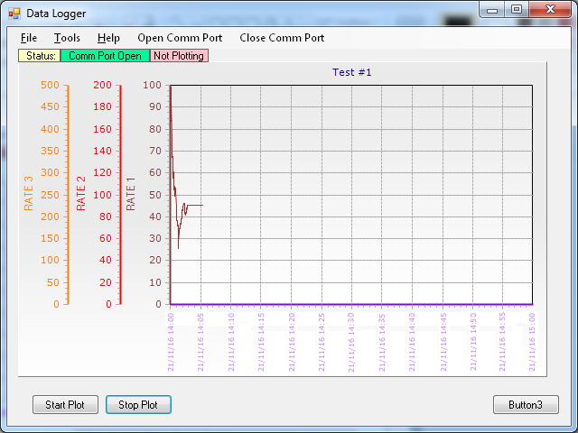

Christopher, Thanks for looking at this.
I tried to implement your suggestion with little success.
Please see the attached screenshot: Screen2A.png
This is what the bottom axis should look like after selecting "Time Mode".
Referring to my original Screen1.png screenshot, it is in "Numeric Mode".
The only differences are the actual text displayed and the orientation of the text.
The orientation is not a problem for me to set, however getting the text (Now -->> Now + 60 minutes) is a problem.
In my code, I have the Maximum value adjustable, and the time base is select-able as well (seconds, minutes, hours, days), however for simplicity in correcting this problem I have chosen 60 minutes.
I have a routine that adds (plots) a new point every 1 second.
(edited/modified with MSPaint)

I came up with an alternative method to achieve my goal.
It has one small issue however, but I will post as a new Issue.
Meantime, here's my fix!
Using buttons to select the mode:
    Private Sub Button1_Click(sender As System.Object, e As System.EventArgs) Handles Button1.Click
        'Numeric Mode
        Dim aa As Integer
        For aa = 0 To 7
            TChart1.Series(aa).XValues.DateTime = False
        Next aa
        TChart1.Axes.Bottom.Labels.ValueFormat = "#,##0"
        TChart1.Axes.Bottom.Maximum = 60
        TChart1.Axes.Bottom.Labels.Angle = 0
        TChart1.Axes.Bottom.Increment = (TChart1.Axes.Bottom.Maximum - TChart1.Axes.Bottom.Minimum) / 12
    End Sub
    Private Sub Button2_Click(sender As System.Object, e As System.EventArgs) Handles Button2.Click
        'Time Mode
        Dim aa As Integer
        Dim bb As DateTime
        Dim cc As DateTime
        For aa = 0 To 7
            TChart1.Series(aa).XValues.DateTime = True
        Next aa
        TChart1.Axes.Bottom.Labels.DateTimeFormat = "HH:mm"
        bb = Now
        cc = bb.AddMinutes(60)
        TChart1.Axes.Bottom.Minimum = bb.ToOADate()
        TChart1.Axes.Bottom.Maximum = cc.ToOADate()
    End Sub
