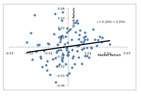

We need to develop scatter chart as shown in below screenshot:
Excel Scatter Chart Example
Excel Scatter Chart.png (16.49 KiB) Viewed 7913 times

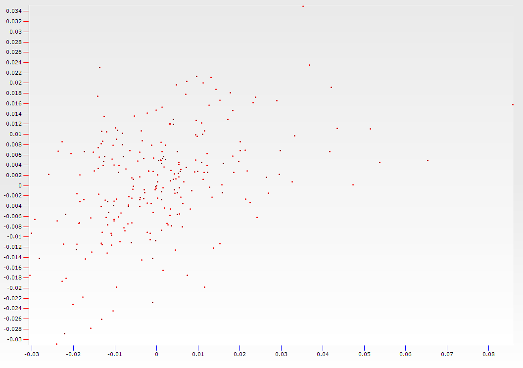

In TeeChart we used Points series to achieve the same, but we are not getting the desired result as shown in above screenshot.
TeeChart Scatter Chart 1
Scatter Chart Error.png (24.45 KiB) Viewed 7910 times

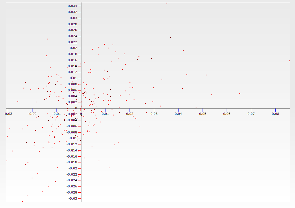

By manually setting teechart properties using TeeChart Editor, it is possible to achieve desired result as shown in below screenshot:
TeeChart Scatter Chart 2
Scatter Chart.png (25.39 KiB) Viewed 7915 times
But we need to achieve the same programmatically at run time (instead of design time) by setting the axis relative position according to (0,0) coordinates.

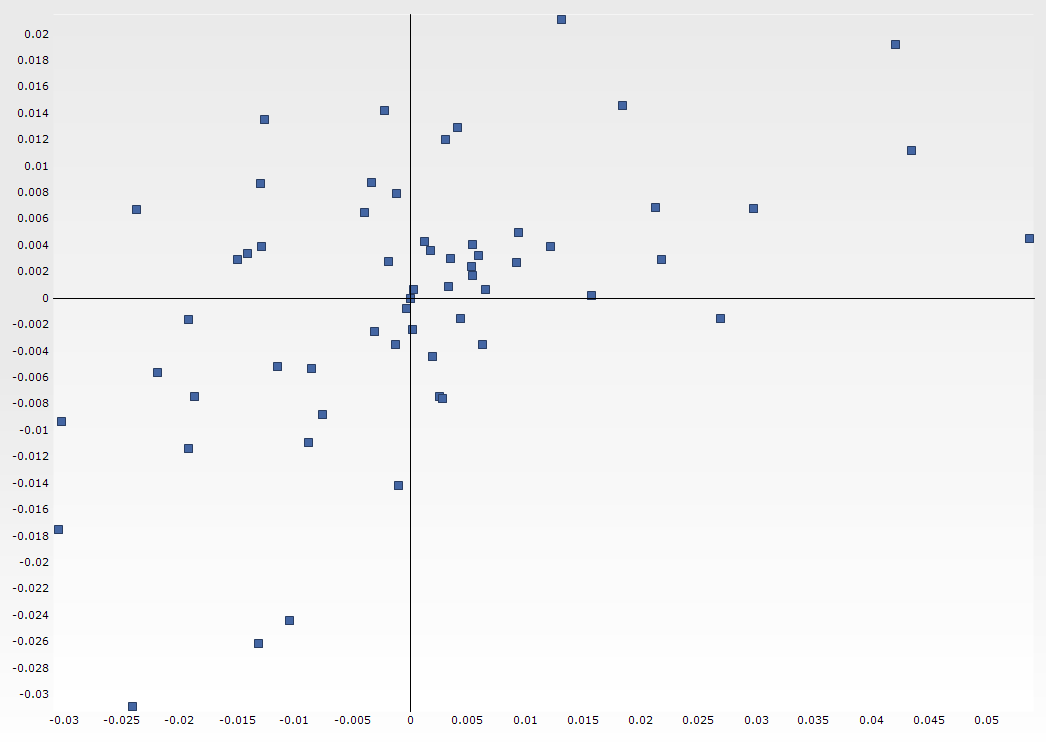

This is not as required. Nevertheless we found the way to solve this programmatically. We added following code snippet which solve our problem:
ColorLine vertiColorLine = new ColorLine(tChart1.Chart);
vertiColorLine.Axis = tChart1.Axes.Left;
vertiColorLine.Value = 0;
vertiColorLine.AllowDrag = false;
ColorLine horizColorLine = new ColorLine(tChart1.Chart);
horizColorLine.Axis = tChart1.Axes.Bottom;
horizColorLine.Value = 0;
horizColorLine.AllowDrag = false;
this.tChart1.Axes.Left.AxisPen.Visible = false;
this.tChart1.Axes.Left.MinorTicks.Visible = false;
this.tChart1.Axes.Left.Ticks.Visible = false;
this.tChart1.Axes.Bottom.AxisPen.Visible = false;
this.tChart1.Axes.Bottom.MinorTicks.Visible = false;
this.tChart1.Axes.Bottom.Ticks.Visible = false;
Check out the final output as shown below:
Scatter Chart Final.png (23.51 KiB) Viewed 7880 times
