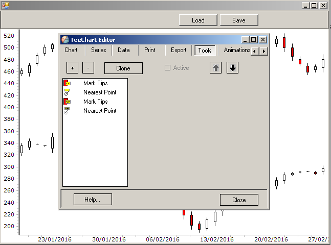

I added single MarksTip and NearestPoint tools in my chart programmatically. It is added twice when I saw it from Tchart Editor window.
I used following code
            Candle newSeries = new Candle();
            newSeries.FillSampleValues();
            Steema.TeeChart.Tools.MarksTip marksTip1 = new Steema.TeeChart.Tools.MarksTip();
            Steema.TeeChart.Tools.NearestPoint nearestPoint1 = new Steema.TeeChart.Tools.NearestPoint();
            tChart1.Series.Add(newSeries);
            tChart1.Tools.Add(marksTip1);
            tChart1.Tools.Add(nearestPoint1);

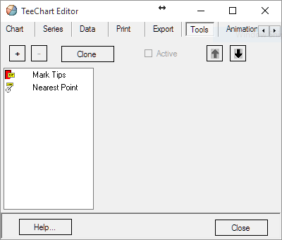

Post by Christopher » Tue Jan 19, 2016 10:15 am
Quant wrote: I added single MarksTip and NearestPoint tools in my chart programmatically. It is added twice when I saw it from Tchart Editor window.
Using the same code and the latest public version of TeeChart, I obtain the following:
