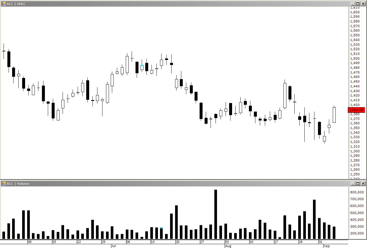

We have used the Latest Version of TeeChart with our Project and we are getting following visible differences as shown in attached screenshots.
With Previous Version of TeeChart
There are two visible differences:
1] Axis Labels Font Size gets increased.
2] Axis Border gets Invisible.
Please let us know how to resolve them.
Note: We didn't change anything in our project. We checked the same with older TeeChart Version again which is working fine.

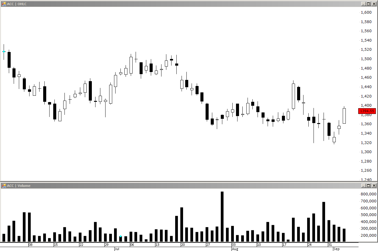

With Latest (Dec-15) Version of TeeChart
Acc Latest.png (42.94 KiB) Viewed 12725 times

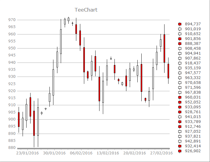

Using TeeChart.dll 4.1.2015.12161, the .NET 3.5 version shipped with the latest release, running the following code:
      tChart1.Series.Add(typeof(Candle)).FillSampleValues();
gives me the following chart:
this is because of changes to the default theme. To change the theme back to that of previous versions, you can use:

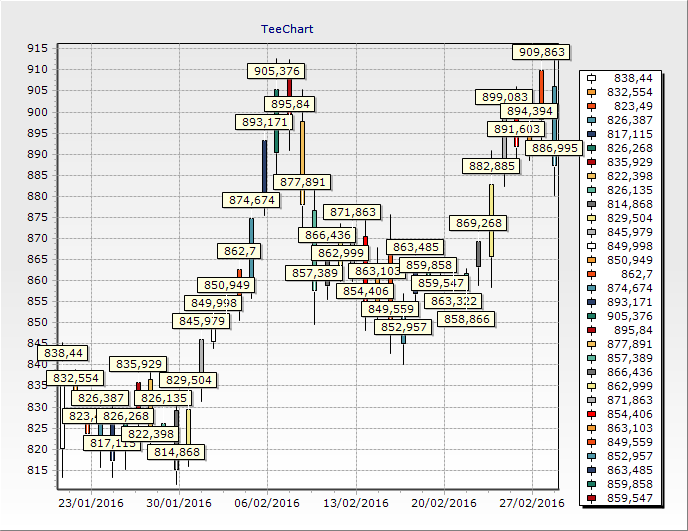

      tChart1.CurrentTheme = ThemeType.Opera;
which gives the following:
We added following code to our project and it changed whole appearance of the chart. :(
Attaching the screenshot for your reference. Please check previously attached screenshot for our original Chart Appearance.
After Opera Theme Applied.png (76.33 KiB) Viewed 12687 times
Re: TeeChart New Version Integration Issue
Post by Christopher » Thu Jan 21, 2016 10:03 am
Quant wrote:We added following code to our project and it changed whole appearance of the chart. :(
Yes, that is the expected behaviour.
May I suggest, then, that you either:
1) change the theme and then apply all the color/font etc. changes you wish
2) do not change the theme, but specify *all* the color/font etc. changes you wish
