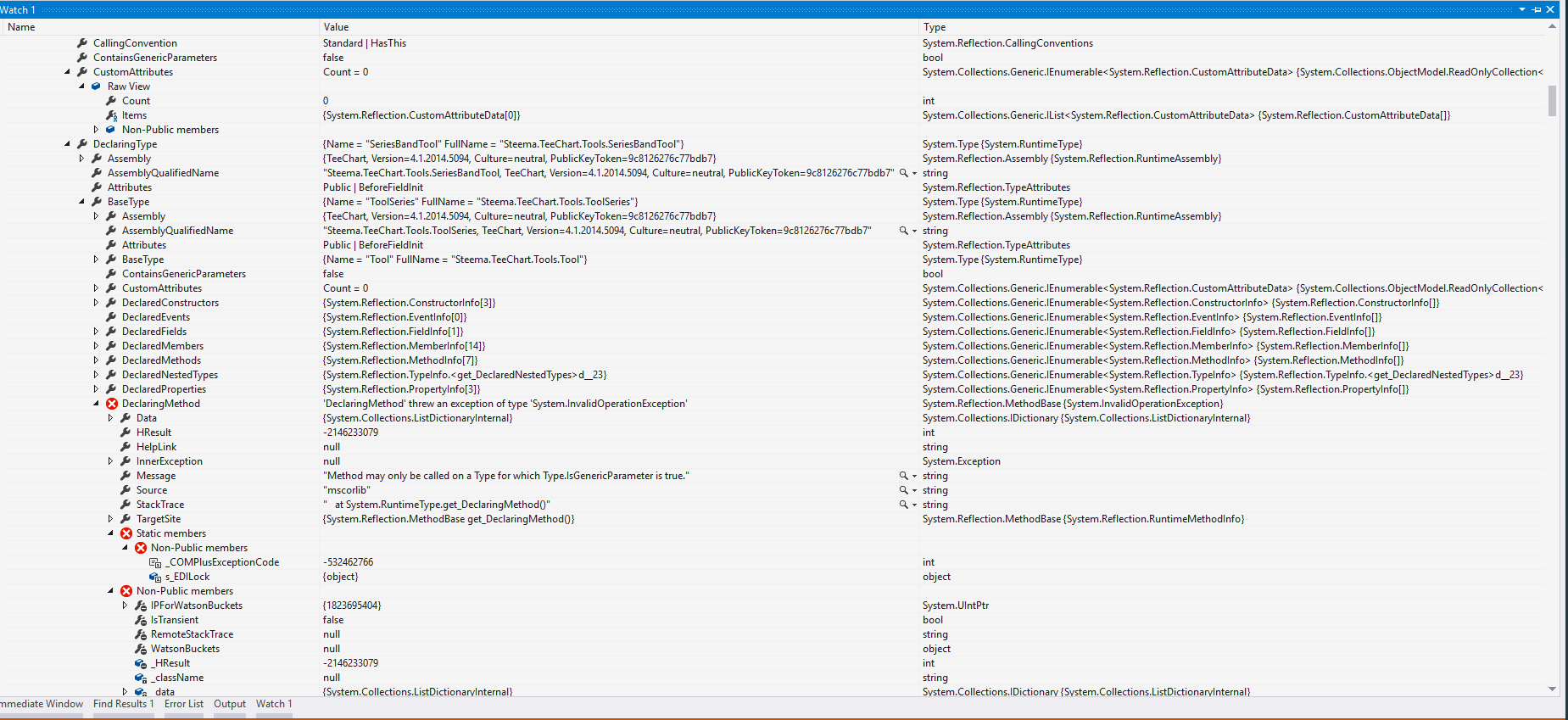

Screen-shot of the exception.
- BitMapException.png (94.07 KiB) Viewed 17242 times

These are from stack trace. I am still trying to reproduce the bug outside of my project.

I do not call anything expect adding 'SeriesBandTool' to chart.
I hope, I can succeed in reproducing this exception in spike solution.
