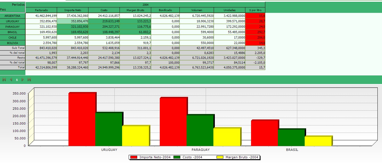

Hi, when show two points, the las bar of first point and the last of the first are drawn one over the other in part. This doesn't occur with three points.
With two points
With two points
With three points

Post by Hermes » Tue Apr 12, 2016 5:40 pm
Solved with:
Steema.TeeChart.Styles.Bar lEstiloSerieBarra = new Steema.TeeChart.Styles.Bar(mGrafico.Chart);
lEstiloSerieBarra.BarWidthPercent = 60;
