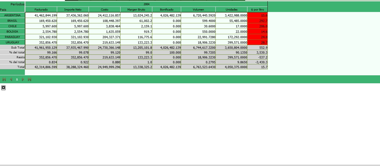

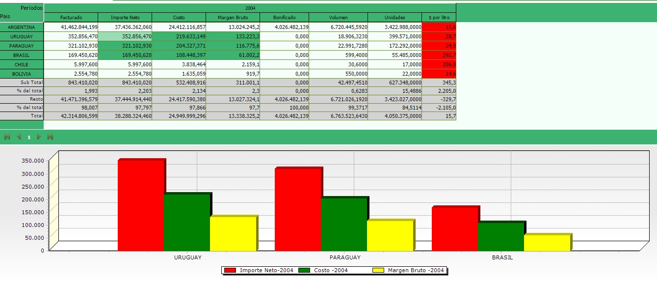

Hi, I have an strange problem since I've updated to 4.1.2015.12164.
The Chart is showed in Chrome (Versión 48.0.2564.116 m) but not in Internet Explorer (Versión 11.0.9600.18205).
Thank you

- IE 11
- IE11.jpg (139.29 KiB) Viewed 11121 times
- In Chrome
- ThreePoints.jpg (197.05 KiB) Viewed 11112 times
