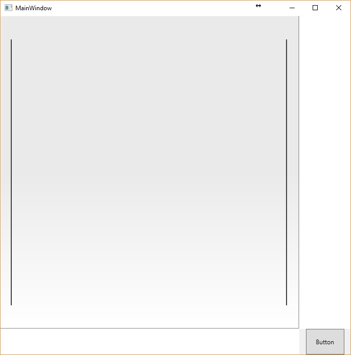

Using the following code with TeeChart.WPF.dll v.4.1.2015.12160
    private void InitializeCharts()
    private void button_Click(object sender, RoutedEventArgs e)
      tChart1.CurrentTheme = ThemeType.Opera;
      tChart1.Header.Visible = false;
      tChart1.Axes.Left.Visible = true;
      tChart1.Axes.Left.AxisPen.Visible = true;
      tChart1.Axes.Right.Visible = true;
      tChart1.Axes.Right.AxisPen.Visible = true;
I get the following two images:
and
do you get the same results?
