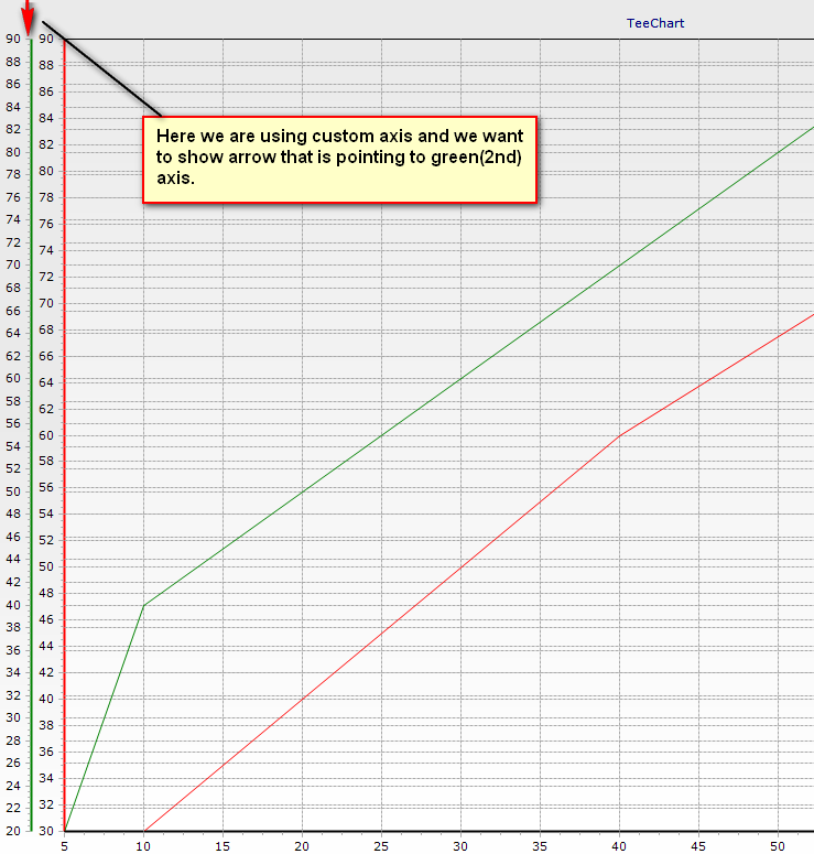

Hi steema support,
We are facing an issue regarding show an arrow on multiple custom axis,
We want to arrow on top of green custom axis.
Please provide me any solution asap.
Thanks in advance
Re: Show arrow on multiple custom axis.
Post by Christopher » Thu Apr 28, 2016 8:10 am
You can try code similar to the following:
      Line line1 = new Line(tChart1.Chart);
      Line line2 = new Line(tChart1.Chart);
      Axis axis1 = tChart1.Axes.Custom.Add();
      line1.CustomVertAxis = axis1;
      axis1.PositionUnits = PositionUnits.Pixels;
      axis1.RelativePosition = -50;
      line1.FillSampleValues();
      line2.FillSampleValues();
    private void TChart1_AfterDraw(object sender, Graphics3D g)
      int xPos = tChart1.Axes.Custom[0].Position;
      int yPos = tChart1.Axes.Custom[0].IStartPos;
      Point from = new Point(xPos, yPos - 40);
      Point to = new Point(xPos, yPos - 5);
      g.Brush.Color = Color.Green;
      g.Arrow(true, from, to, 10, 10, 0);
