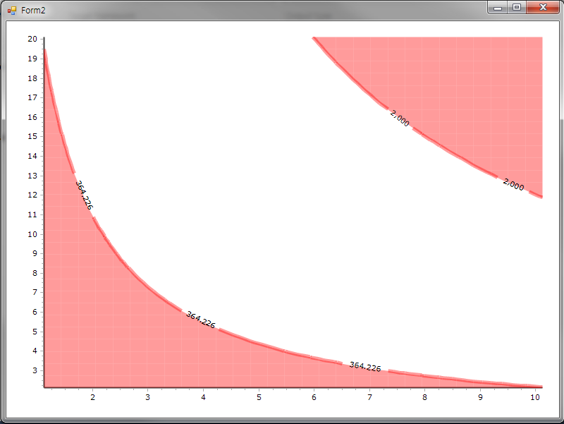

DEV1 wrote: Currently, I set UpToValue to 364.2261. When I change UpToValue to 364.226, it does not color the region anymore.

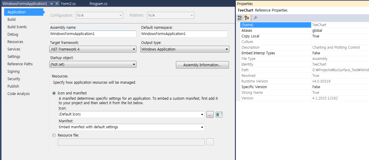

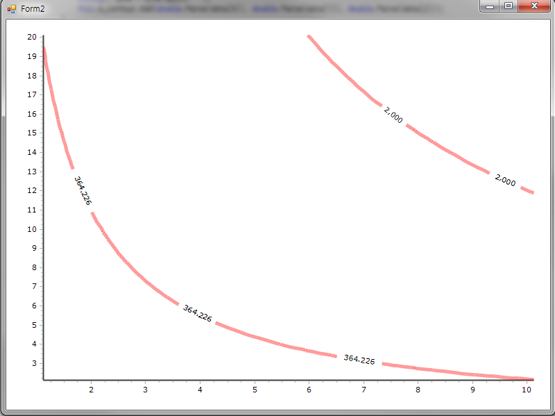

I am attaching three screenshots to show the issue that you were not able to reproduce.
As I was watching your video, I noticed that the version you are using is not really the same.
A file named Version.png displays what is our T-Chart is as well as Target Framework.
A file named 364.2261.png displays a T-Chart with proper coloring when UpToValue is set at 364.2261.
A file named 364.226.png displays a T-Chart with improper coloring when UpToValue is set at 364.226.
I would like to investigate this matter further as it is very important for us to make sure that this behavior is never produced.

Re: Surface Chart and Contour Chart Issues
Post by Christopher » Wed May 11, 2016 10:52 am
DEV1 wrote: I would like to investigate this matter further as it is very important for us to make sure that this behavior is never produced.
I have found the cause of this issue and have already fixed it. Unfortunately, unless you have the TeeChart source code, there is no workaround that can be applied. The fix will be included in the next maintenance release, due out within the next few working days.

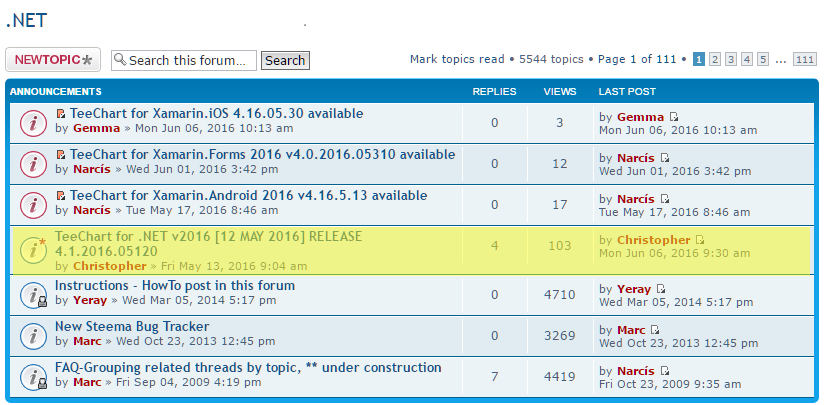

Post by Christopher » Tue Jun 07, 2016 9:30 am
DEV1 wrote:I am waiting for your next maintenance release. You told me that it would available in a few days.
I would like to know if the maintenance release is ready and it sure fixed the problem that I mentioned.
Please let me know as soon as possible as we need to update out software as quickly as possible.
The new maintenance release was announced nearly a month ago at the top of this forum, as you can see here:
I can affirm that a fix to your issue is included in this release.
