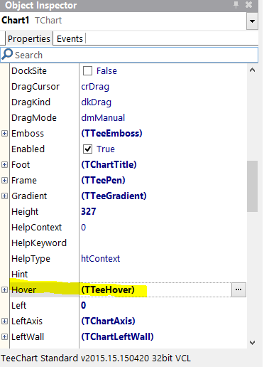

Hi I am migrating an old software written in Delphi to .net Winform application. Every things works perfectly well except I could not find a chart hover functionality in .net version. Please see attached image
Hover option in Delphi version
In Delphi version when I hover the mouse over the series, it highlights the line with red color and this was built in functionality in Delphi chart. see attached image

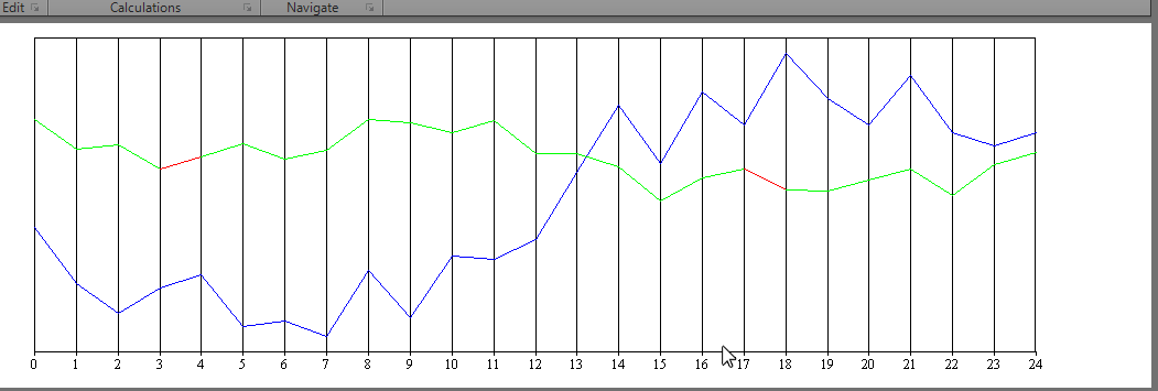

Following is the effect.
I would like to achieve the same in .net version, please advice how to do this.

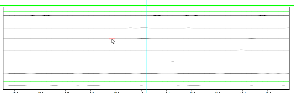

this is exactly what i was looking to implement. but one problem when mouse leaves the series it should re apply series color on the line instead of red. Currently when mouse leaves the series it left the line red. please see attached image
can you tell me how to reset the color when mouse leaves the series...?? so as per example if mouse leaves the series it should be green..
