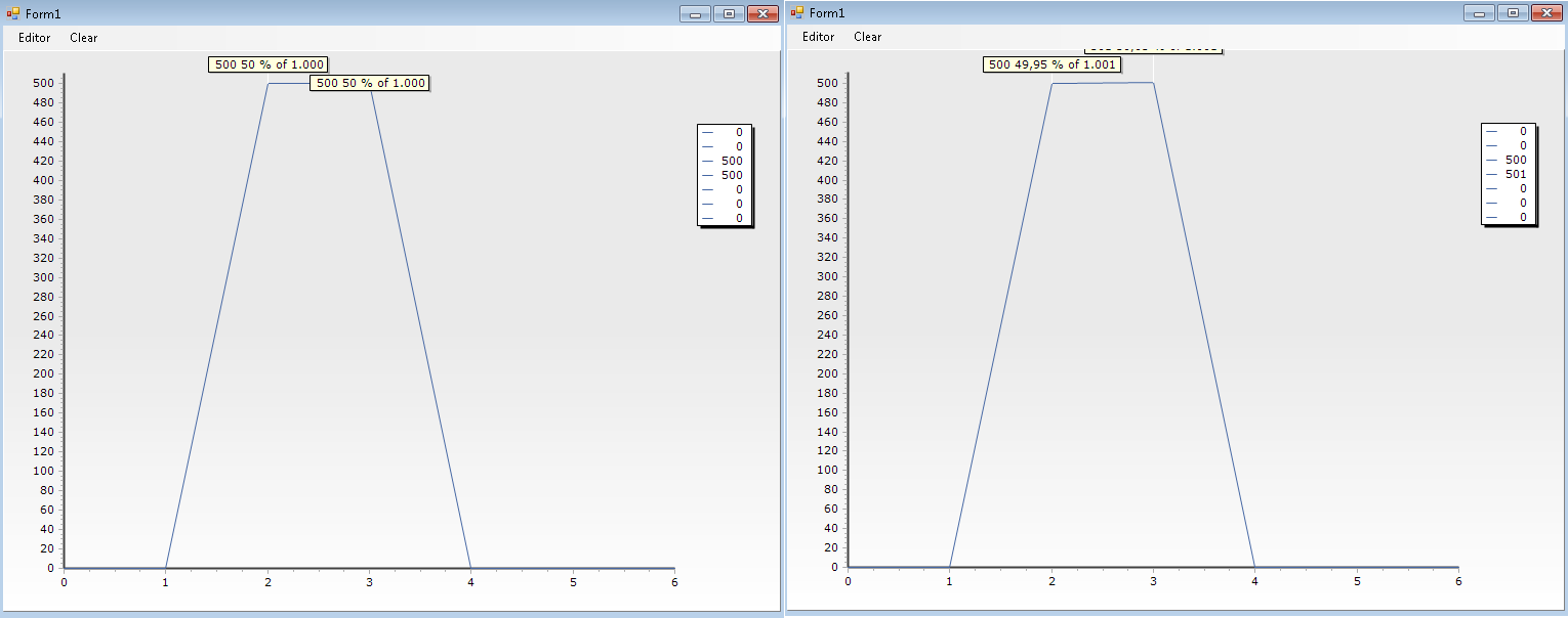

In our project, we are using SeriesMarks.AutoPosition, since this option makes sure series marks are put at an optimal position and we don't have to bother about putting marks at custom positions.
However, we bumped into the following situation, where the series mark is cut off at the top of the chart: (left: 2 values of 500, no cutoff - right: 1 value of 500, 1 value of 501, cutoff)
Left: no cutoff - Right: cutoff

It seems strange that in the right image, the 2nd series mark is placed above the 1st series mark, causing it to be cut off, while there is plenty of space below the 1st series mark, so it should not be cut off. (as is done in the left image)
Is it possible to make sure the series mark is not cutoff in the right image without using custom series marks positions?

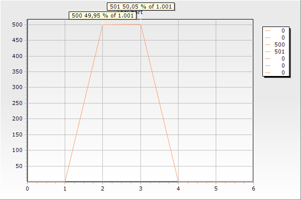

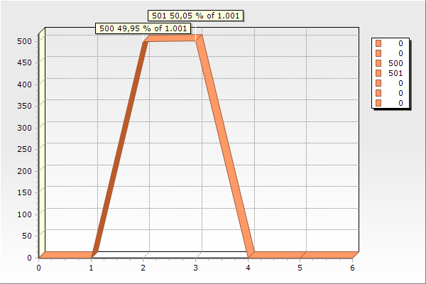

Using the latest version of TeeChart.dll, the chart created by your code looks like this:
toggling to 2D gives me this:
which version of TeeChart.dll are you using?
