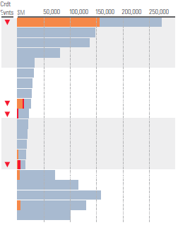

Hi
I am trying to achieve this.
I am facing below challenges
1)Can i show a custom y axis as you can see in image little *Red* V icons
2) Also is there a way i can shade gray couple horizontal bars e.g i want to shade alternate 5 bars
This is i am able to achieve.

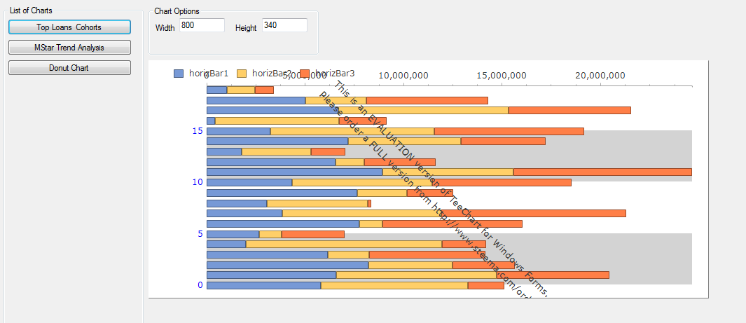

Is there a way i can cover exactly 5 bars by gridband. As of now Gridband start middle of ticks
Also i am not able to get rid of bottom axes and the spaces highligted in Red
Note: Left Axis ticks are temporary

Re: Horiztal Bar Top Axis and Custom Y axis
Post by Christopher » Fri Aug 19, 2016 10:46 am
You're very welcome.
Possibly the quickest way to achieve this is again to draw elements on the chart, e.g.

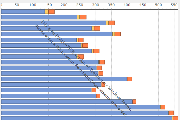

Legend and Chart top is overlapping , Also grid lines are not showing from top axis

Post by Christopher » Tue Aug 23, 2016 7:44 am
Would you please be so kind as to retouch your example so I can compile and run it here? I'm afraid I do not have access to your ChartBuilderParam object.
rpt
Posts: 24
Joined: Wed Aug 09, 2006 12:00 am
Post by rpt » Tue Aug 23, 2016 12:42 pm
Post by Christopher » Tue Aug 23, 2016 3:06 pm
Thank you for your code. The problem can be corrected by adding one line to SetCommonProperties():
            tchart.Legend.CustomPosition = true;
            tchart.Legend.Top = 10;
            tchart.Legend.Left = 30;
            tchart.Panel.MarginTop = 10;
The reason the MarginTop is necessary is because you have set CustomPosition to true.
