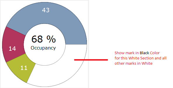

Is this possible to have Marks in different color based on some condition
Re: Donut Chart Annotation
Post by Marc » Wed Dec 07, 2016 3:48 pm
This would be a way to achieve it:
//add event
donut1.GetSeriesMark += new Steema.TeeChart.Styles.Series.GetSeriesMarkEventHandler(donut1_GetSeriesMark);
private void donut1_GetSeriesMark(Series series, GetSeriesMarkEventArgs e)
      if (e.ValueIndex == 3)   //add your criteria, here 4th point
        series.Marks.Font.Color = Color.White;
        series.Marks.Font.Color = Color.Black;
series.ValueColor(e.ValueIndex) would give you the Point colour if you were to wish to check by that.
