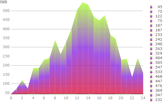

When I use area series, set up its gradient colors and then add it to chart, its gradient's StartColor is reset to some default value. MiddleColor and EndColor are correct. Please see the example below to reproduce:
Area area = new Area();
area.AreaBrush.Gradient.StartColor = Color.GreenYellow;
area.AreaBrush.Gradient.MiddleColor = Color.BlueViolet;
area.AreaBrush.Gradient.EndColor = Color.Crimson;
area.AreaBrush.Gradient.UseMiddle = true;
area.AreaBrush.Gradient.Visible = true;
area.FillSampleValues();
chart.Series.Add(area);
I'm using version 4.1.2016.05120 and it worked fine in 2.0.2652.22325.

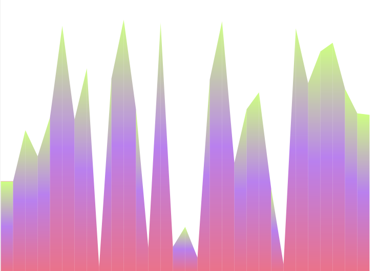

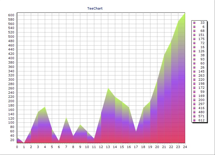

Thanks for reply, the first workaround works. However, I have another problem. When I use transparency and want to hide area lines, 1px-wide gaps appear. Can be reproduced with:
area.Color = Color.GreenYellow;
area.AreaBrush.Gradient.Transparency = 20;
area.AreaLines.Visible = false;
This is how it looks:
This only happens if transparency is used. If I set GradientRelative to false, gaps dissapear, but some other problem pops up, so I'd like to avoid it. It worked in 2.0.2652.22325.

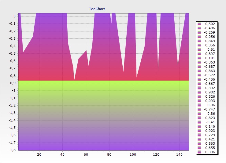

Unfortunately, this doesn't work for me if the data is irregular:
var x = 0d;
for (int i = 0; i < 30; i++)
    x = random.NextDouble()*10 + x;
    var y = random.NextDouble()*5;
    area.Add(x, y);
chart.CurrentTheme = ThemeType.Opera;
This produces:

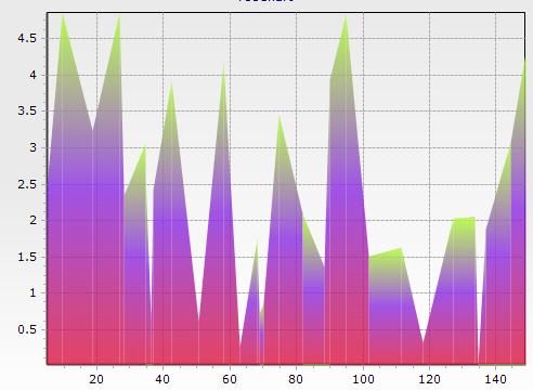

The answer here is to change the SmoothingMode, e.g.
    Random random = new Random();
      tChart1.CurrentTheme = ThemeType.Opera;
      tChart1.Graphics3D.SmoothingMode = SmoothingMode.HighSpeed;
      area.AreaBrush.Gradient.GammaCorrection = true;
      area.LinePen.Visible = false;
      var x = 0d;
      for (int i = 0; i <= 30; i++)
        x = random.NextDouble() * 10 + x;
        var y = random.NextDouble() * 5;
        area.Add(x, y);
      tChart1.Series.Add(area);
which gives me:

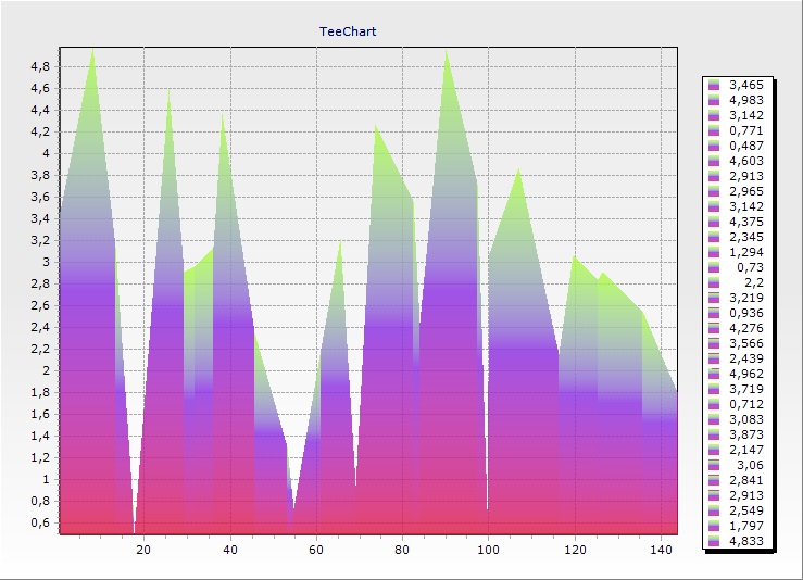

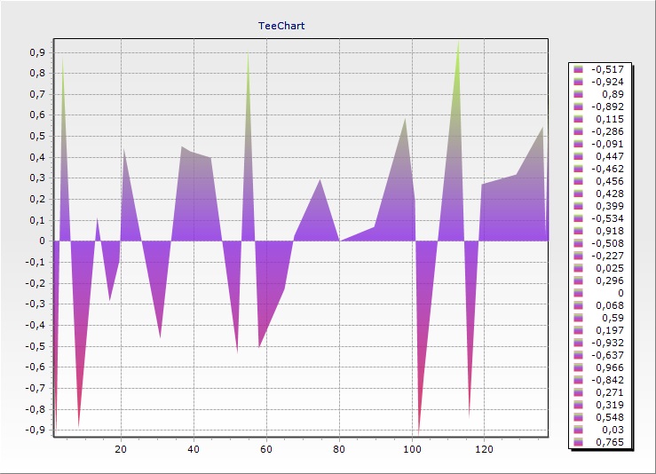

When I used GradientRelative then area's color became solid below y-value of 1. But nevermind, we decided to simply disable area's antialiasing for the time being. Thanks for the assistance.
Re: Adding area to chart modifies its StartColor
Post by Christopher » Wed Sep 07, 2016 8:42 am
Using the following code:
      area.GradientRelative = false;
      area.Origin = 0;
      area.UseOrigin = true;
      var x = 0d;
        double y = random.NextDouble();
        bool flag = random.NextDouble() < 0.5;
        y = flag ? y : y * -1;
        area.Add(x, y);
I get this chart:
Is this not what you expect?

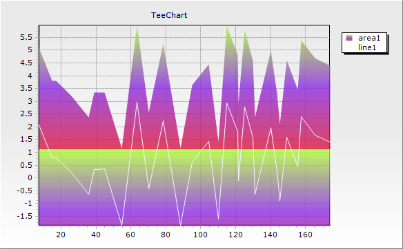

I reproduced the problem in a sample app. It's not actually below 1 and not solid color (that was true for the data and settings in my actual application), but rather a "restarted" gradient below lowest y-value of an area. It happens when there are more multiple series. It looks like a rectangle is drawn below an area chart and its gradient is drawn separately from area above it:
            var data = GetData();
            area.Color = StartColor;
            SetData(area, data);
            Line line = new Line();
            line.Color = Color.AliceBlue;
            var newData = data.Select(p => new Point(p.X, p.Y - 3));
            SetData(line, newData);
            chart.Series.Add(line);

        area.Add(x, y);
and then use the mouse to scroll the chart upwards, I get this:
I have added this to our issue tracker with id=1625.
