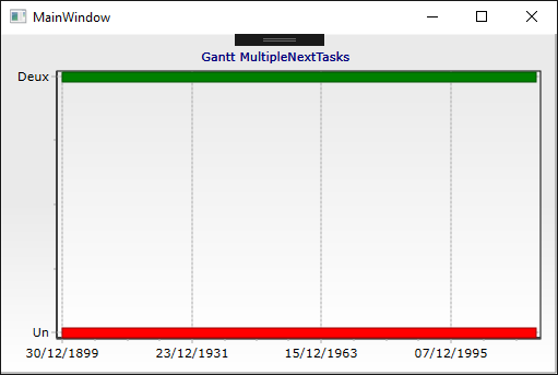

Philippe

Post by Philippe » Tue Sep 06, 2016 12:57 pm
Dear Christopher,
Thank you very much for your reply.
I applied your code but the result is wrong about the date displayed.

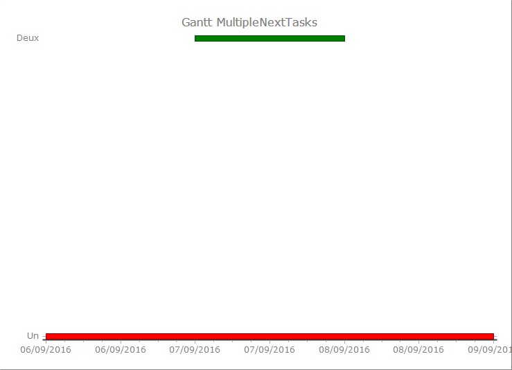

Re: Binding Gantt
Post by Christopher » Tue Sep 06, 2016 4:46 pm
Hello Phillippe,
Many apologies for not seeing that issue earlier - I have added it to our ticket tracker with id=1621 and have already resolved it, meaning that a resolution to this problem will be found in the next maintenance release, due out in the middle of this month. I'm afraid to say that there is no workaround available to this issue.

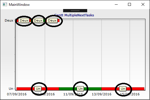

Is it possible to have the Marks with different value ?
How to do it ?
Thank you
Philippe
Re: Binding Gantt
Post by Christopher » Wed Sep 07, 2016 9:23 am
Hello Phillippe,
You always have the option to do something like this:

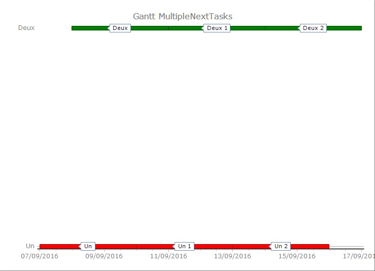

which will give you the following chart:

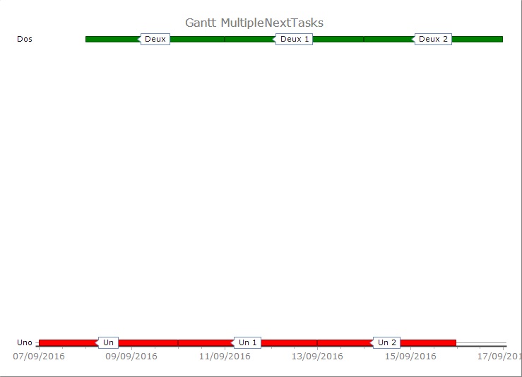

Christopher,
Yes, but the first 'Mark' value is the same of the Label !
No other possibilities to avoid this ?

Re: Binding Gantt
Post by Christopher » Wed Sep 07, 2016 3:06 pm
Hello Phillippe,
Yes, you can use Custom Labels, e.g.

      tChart1.Axes.Left.Labels.Items.Add(1, "Uno");
      tChart1.Axes.Left.Labels.Items.Add(2, "Dos");
which gives me:
