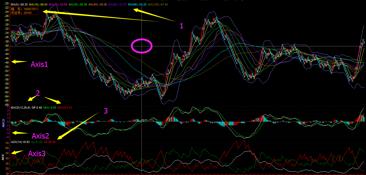

As shown in the figure
Dim tChart As New Steema.TeeChart.TChart
Dim Axis1 As New Steema.TeeChart.Axis(tChart1.Chart)
Dim Axis2 As New Steema.TeeChart.Axis(tChart1.Chart)
Dim Axis3 As New Steema.TeeChart.Axis(tChart1.Chart)
Dim CursorTool1 As New Steema.TeeChart.Tools.CursorTool(tChart.Chart)
CursorTool1.FollowMouse = True
Dim MyLine(0 to 20) As New Steema.TeeChart.Styles.Line()
tChart.Axes.Custom.Add(Axis1)
tChart.Axes.Custom.Add(Axis2)
tChart.Axes.Custom.Add(Axis3)
Axis1.Horizontal = False
Axis2.Horizontal = False
Axis3.Horizontal = False
tChart.Series(0 to 10).CustomVertAxis = Axis1
tChart.Series(11 to 14).CustomVertAxis = Axis2
tChart.Series(15 to 20).CustomVertAxis = Axis3
problem One: in the help file, only add a Series example, did not add multiple Series multiple Axis example, if you specify CursorTool1.Series = tChart.Series (0), then only in the Axis1 region of CursorTool1, while the area I want is the tChart; if the specified CursorTool1.Series =Nothing, when the mouse moves the only vertical line with the mouse and the horizontal line is always in the middle position of the level of tChart, in this tChart, how to add a full screen mobile CursorTool1
Problem two :1、2、 3 in the figure, the display is TChart1.Series (0 to 20).YScreenToValue (e.Y), I do not understand the three:
A、 what is this tool, how to use the code to add, and specify its location in Axis1, Axis2,.StartPosition Axis3 on the right.
B、 in 1 of the body that similar to the Label tool is what, his font, color, content, location and how to set.
C、it is how to do the font color is not the same, can automatically shrink.
figure
