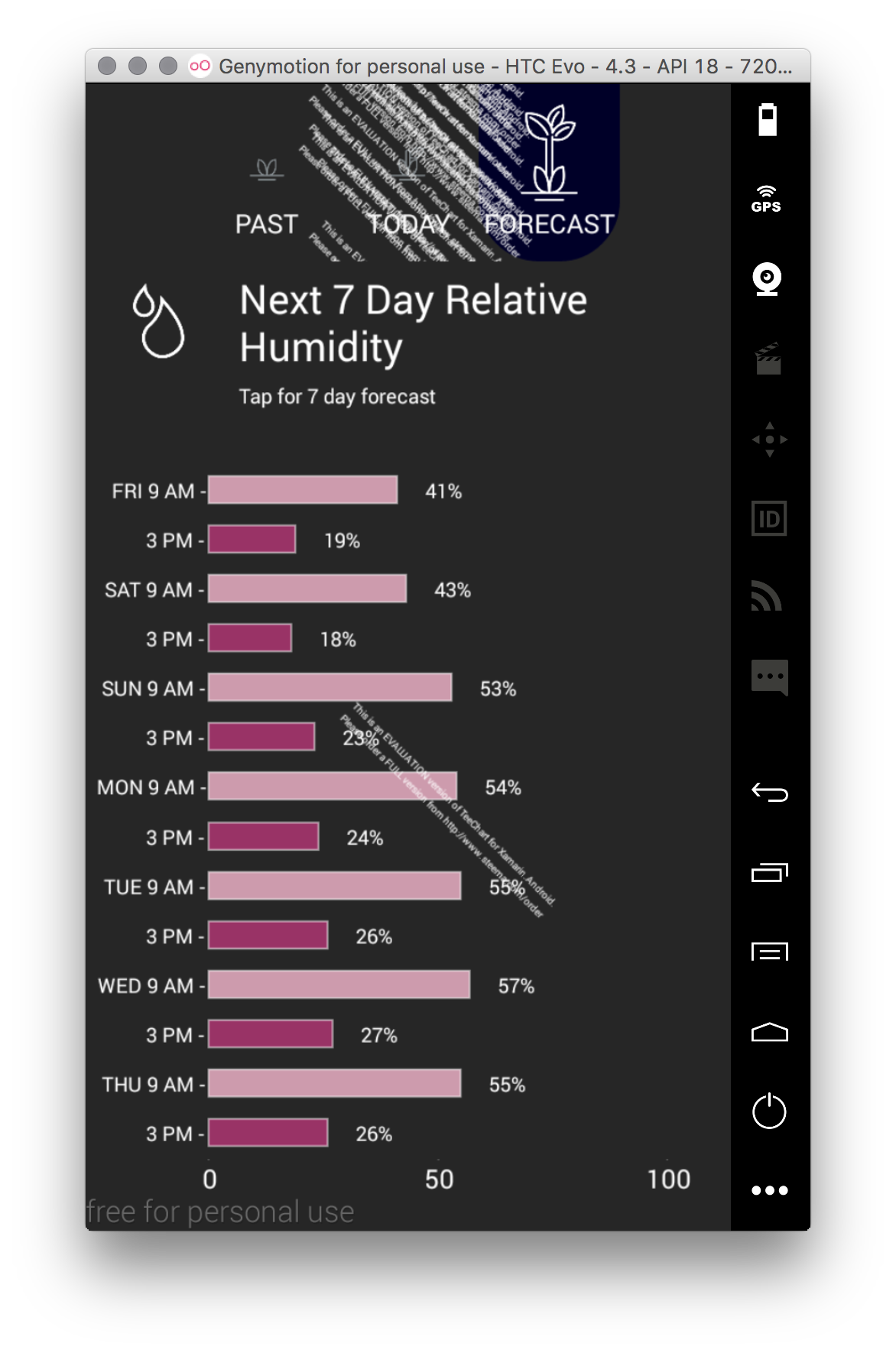

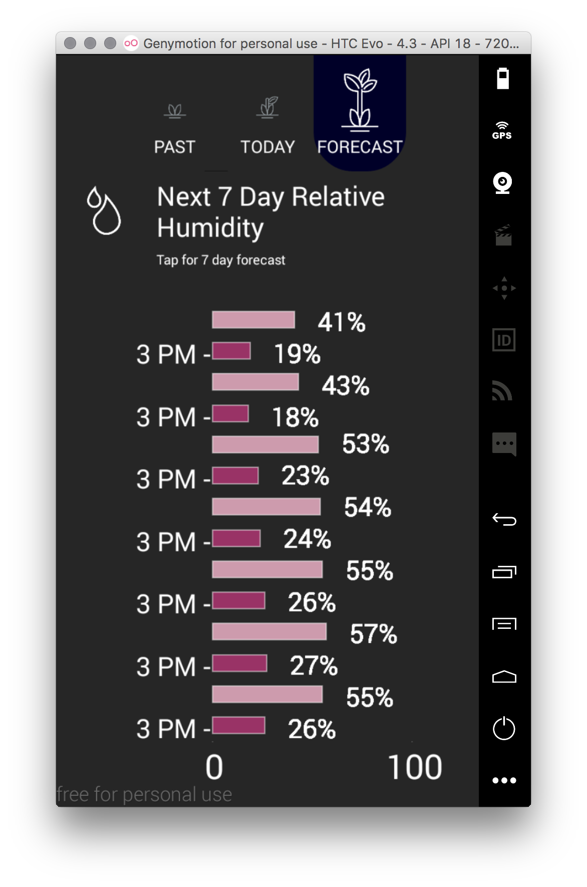

PS: I did attach two snapshot one taken using the trial version (good) and one using the official library (bad)
The chart as it is displayed using the trial; xamarin component
Screen Shot 2016-12-02 at 11.23.50 AM.png (465.55 KiB) Viewed 10024 times
Bad Chart (please see fonts)
The chart as it is displayed using the official library
Screen Shot 2016-12-02 at 11.07.06 AM.png (397.47 KiB) Viewed 10026 times

In my previous post, I thought I did mis-configure the installation of the licensed Chart library. However, it seems that the new library displayed all fonts incorrectly. It seems that it is a new feature, but unfortunately this new feature is not backward compatible.
I had to go through all font size settings and adjust it and divide each setting by 'pixel by sp'.
I could not find any documentation regarding this new 'font size' feature.

theyield wrote:I had to go through all font size settings and adjust it and divide each setting by 'pixel by sp'.
Indeed, we did some modifications to improve the font sizes supporting any ComplexUnitType (by default using ComplexUnitType.Sp) in any font.
We did this change because until then, setting a font size was giving a very different result in different devices.
I'm sorry for the inconvenience generated.
