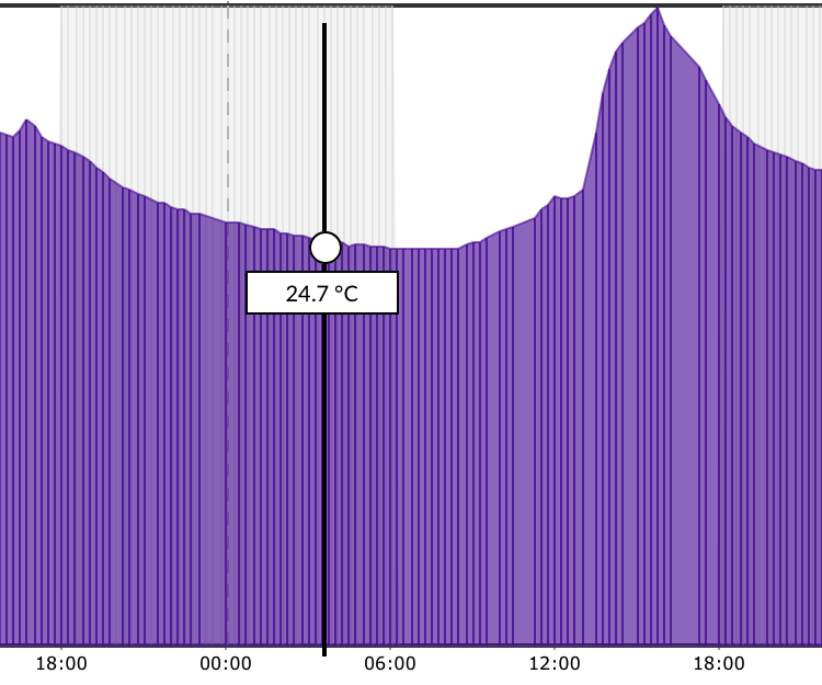

hi,
i am unable to get a proper transparency in my area?
I have tried setting it on the series and on the area and neither works.
if i use a argb color on the series it kinda works but then these lines show up and i cant hide them?
ie. series.Color = Color.FromArgb(58,214,214,214);
using TeeChart.iOS.Unified
4.16.6.20

Re: Transparency in Area Series
Post by Sandra » Thu Feb 16, 2017 10:50 am
Hello theyield,
I think can helpful for you combine the code below to resolve the problem you're experiencing:
area2.AreaLines.Visible = false;
area2.Opacity = 0;
area2.Transparency = 100;
area2.Color = Color.FromArgb(58, 214, 214, 214);
Hoping this helps you, otherwise don't hesitate to contact us.

theyield
Posts: 16
Joined: Thu Sep 22, 2016 12:00 am
Post by theyield » Thu Feb 16, 2017 10:00 pm
Unfortunately this did not help to get rid of the vertical lines. Any other suggestions?
Post by Sandra » Tue Feb 21, 2017 9:14 am
Hello theyiedl,
I would like inform you, after doing some tests, we have added the problem you're experiniencing in Teechart.Net bugzilla tracker to fix it to upcoming versions. Here's the link: http://bugs.teechart.net/show_bug.cgi?id=1793
Feel free to add your mail to the CC list if the ticket to be automatically notified when an update arrives.
Thanks in advance
